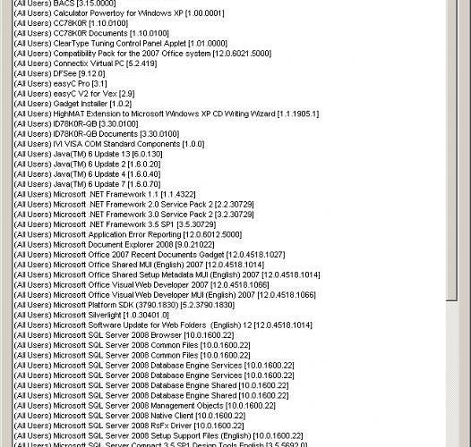

This Utility looks like this:
https://vexforum.com/attachment.php?attachmentid=1896&stc=1&d=1247567452
You might be able to see that EasyC v2 and EasyC Pro are installed with the “Windows Installer”. RobotC is also installed with the “Windows Installer” as well as lots of other Software. When launching any of these applications, their StartUp can be affected by any other of the applications, that are Mis-Configured, or have been Corrupted During their Install, or Uninstall, or in General Disk Corruption.
You will most likely need to run a Registry Cleaner like the one in CCleaner to remove Registry Entries to the Mis-Configured Application, after the Application has been removed from your Computer, one way or the other and the “Windows Installer Clean Up” Utility has been run. Don’t forget to make a Backup of the Registry before the “Cleaning Process”, just in case.
