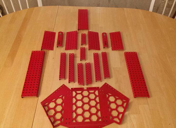

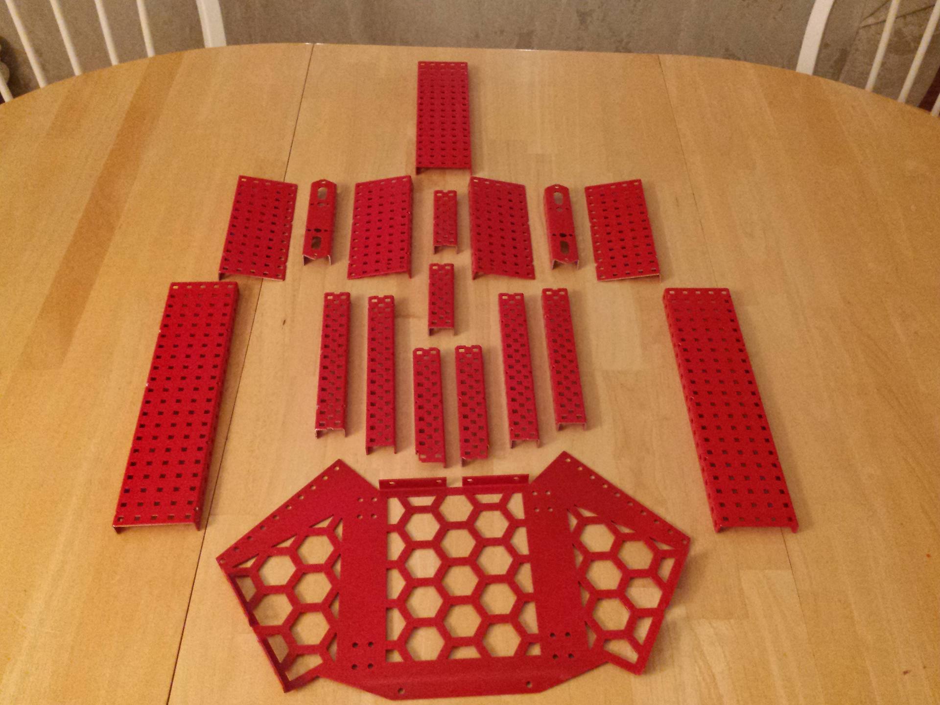

I’ve only ever done spray paint jobs for VEX stuff. When done correctly with good cleaning and a couple solid coats and given a day or two to dry, parts turn out pretty well. I’ve attached some pictures from one of the NAR robots that did red spray paint last season.
Those do look very nice. I was lucky enough to have a parent who found some great people in the business who sponsored us by providing the chemicals and dyes. Setting up the line wasn’t cheap, but it was a whole lot easier to handle with the donations. A really great garage sale allowed us to stock up on other items we needed. My guys have worked hard to learn the process and that has been the most rewarding experience. Plus if we feel like we need a little color, we just fire up the heaters and run a batch. Boom nice pretty metal for our robots.
Honestly, Spray paint is good and all, but it makes the metal heavier. That’s why some teams such as team 60 have used anodizing since it is much lighter. But if you are very busy and have no time to decorate then spray paint it.
