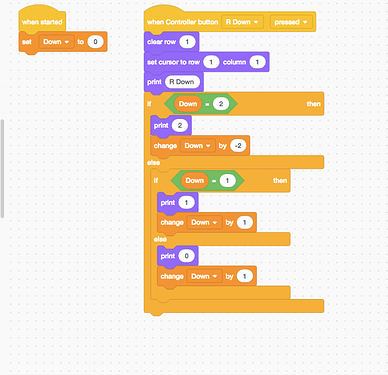

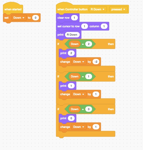

Sometimes when working with code like this, it’s a good idea to also print some output so you can see what’s going on. Here’s a small program that implements the same finite state machine that you are trying to use.
When this program is run, the output seen follows the following sequence
press 1 -> R Down 0
press 2 -> R Down 1
press 3 -> R Down 20
press 4 -> R Down 1
press 5 -> R Down 20
so there’s some issues in the logic, it doesn’t follow the 0, 1, 2, 0 sequence that I think you wanted.
The problem is that when down is 2, the first if statement executes and sets down to 0, but the if statement testing for down to be 0 is also executed, and that then sets down to be 1.
You probably want to change that code so only one conditional executes every time you press R down.

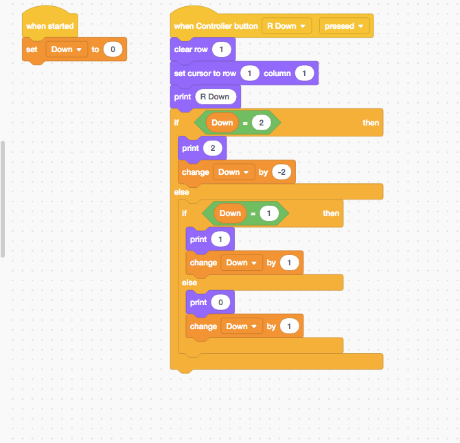

one solution would be

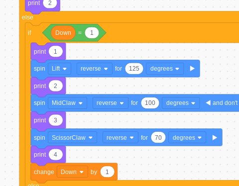

Ok, so I used the print option and I was able to find where the code stopped. It still did the same issues for both statements after I changed it to the if else blocks. The brain only printed up to 3.
EDIT:
Did some further testing and was able to able to get it to do the scissorclaw statement and it printed 4. However, the midclaw still moved forward again a few seconds after 4 was printed which I don’t know why. I am further testing so I will probably find more problems and fix them soon.
