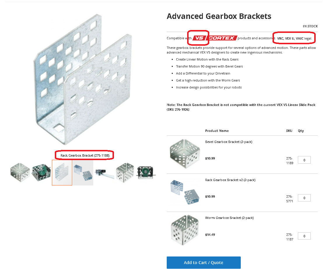

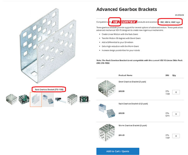

actually, two questions:
  1. are drivers allowed to manipulate the robot once it’s been plugged into the field control system and disabled, to make sure it fits within the sizing constraints?
  2. is this bracket (part 275-1188 ) VRC legal? It does say VRC legal in the description which applies to all the products on that page, but that particular model cannot be added to the cart.
Regarding the gearbox bracket…
I believe that bracket is still legal as it is part of the linear motion kit that is listed on the page of discontinued parts. Parts found on this page are still legal, even though you can’t buy them.
