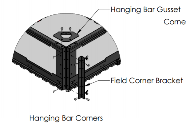

**Does anyone know whether the gusset holding the high hang bar is considered to be part of the field perimeter? If not, then would it be legal to touch the gusset and achieve a high hang? **

Attached is an image of the gusset I am talking about:
Yes, this would be legal. The Hanging Bar Gusset is technically not part of the field perimeter.
