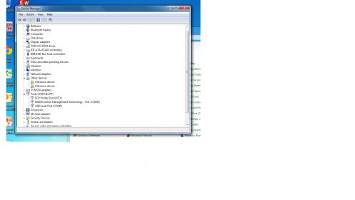

squirrelbot,
While the cable is connected to your PC, please take a screenshot of your Windows Device Manager.
It should look like the PDF attached.
-Eli
Doc1.pdf (118 KB)
Sorry I’ve taken so long on this. I abandoned the old programming cable and bought the new one, but the problem is still the same, The computer appears to recognize the device, and even installed the driver when we first plugged it in, but the Program doesn’t see it. I’ve attached the view that was asked for.
Keep in mind that we have up to date code and the new programming cable.
So i got to checking around and found out that the automatic setting in EasyC isn’t finding the right port, I switched to manual and it works like a charm now.
