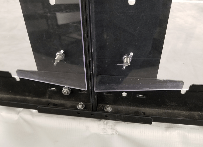

My school is trying to setup the In The Zone field and noticed it is not possible to install the long (red/blue) poles and screw them onto the premiter wall because the plexiglass is covering the holes.
I didn’t notice anything about this being mentioned on the instructions.
Are we supposed to cut the glass in order to screw in the pieces?
Some help would be advised.
Thanks in advance!

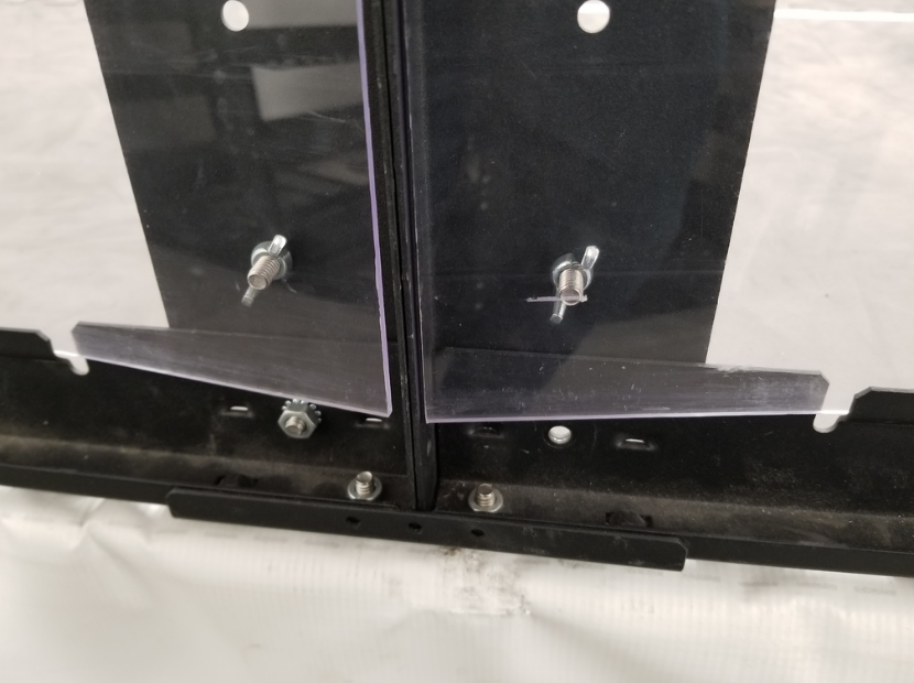

The intended installation procedure is to slide back the Lexan panel, install the screw/nut, and replace the panel such that it covers over the nut. A slight bend in the Lexan to accomodate this is expected.
Drilling a clearance hole through the Lexan panel is an acceptable alternate, provided that the holes do not interfere with gameplay.
