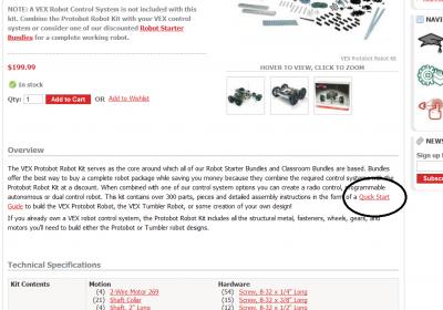

kurtis18xl,
The easyC online window will only work after you download an easyC program, like the easyC deafult code.
Also are you using 2-wire motors or 3-wire motors?
If 2-wire motors, make sure to use the Motor Controller 29 between the motor and the Microcontroller.
Look at page 24-26 of the Quick Star Guide: http://www.vexrobotics.com/products/vex-robot-starter-bundles/276-2231.html
-Eli
