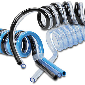

Is it legal to use coiled tubing at all? Or in the case we cant use coiled tubing could we do it ourselves and still be legal?
For an example:
Something like this
For an example:
Something like this
Let’s take a look at the applicable rules from the VEX Gateway Game Manual
Thus, the only pneumatic tubing allowed would be the tubing that is available from VEX or an identical version of the official tubing. Thus purchasing off the shelf pre-coiled tubing would be illegal. However, there are no rules prohibiting you from coiling your own VEX legal pneumatic tubing.
