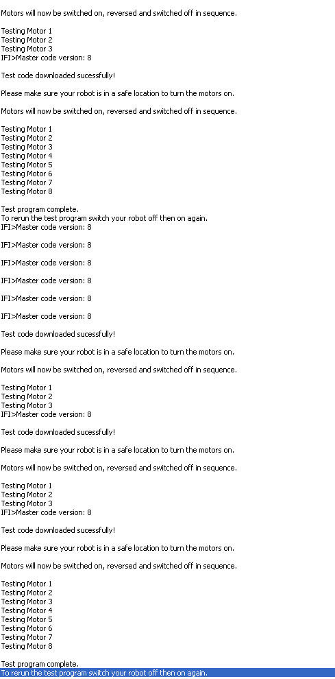

I tried to run the Test Code, but its got issues with consistency. Almost 80 percent of the times I ran the code it ended up showing the line “IFI> Master Code Version 8” with a little jerk motion of a single or more motors when every time the line comes up.

Running it without Vex Net and now the problem seems to be getting out of hand. I can’t get past Testing Motor 1 and it is getting executed again and again that way. :frowning:
Please Help, as this is not letting me run any other programs either.

I am using Easy C V2.9.3.0 with Master Code V8d
I tried updating it to Easy C V2.9.3.3 with Master Code V10
Yet, I am still getting the same error.

**Just to clarify things - you state that you are receiving the error "FI>Master Code Version: 10 ", yet your screen shot shows version 8. Which one is it?

The Master Processor keeps resetting the Vex Controller…
A Low Battery, or Bad Code in the User Processor will cause this behavior. If you reload the Vex Default Code, does the problem go away??

Anyway, The problem has been solved,:rolleyes: and the source for it was that I was using almost depleted batteries in the receiver which lead to it.

The problem was indeed with Low Battery and has been solved after replacing them with new ones.
