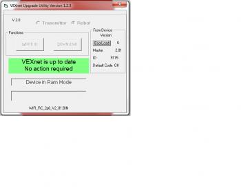

dave,
The two blinking LEDs on your Cortex (Robot & Game) mean that your unit is in a download state. I would recommend you run your Cortex though the VEXnet Upgrade Utility again, and make sure it downloads successfully (see attachment).
Also I meant to say download Mastercode & Usercode (default code).
Which upgrade Utility did you used, the one from easyC or the one listed in the VEX website?
If you used the one from our website, the default code should be downloaded automatically; however, if you used the one provided by easyC you will need to do the following:
When I connected the cortex to the PC and ran the Vexnet Upgrade Utility version1.2.3 it reported the Vexnet was up to date Noaction required. I had earlier gone to the downloads page and downloaded the latest version of the Upgrade Utility, but I don’t know the designation (for example version 1.2.7) for it, to know if it successfully downloaded. Currently I have 2 VEXnet Upgrade Utilities-version1.2.3 and version 1.2.3(OEM).Also currently when I open the easyC tab, listed are 5 programs: easyC for Cortex, easyC help, IFI VEXnet Firmware Upgrade, intelitek Loader, and VEXnet firmware upgrade utility. The IFI firmware upgrade and Vexnet firmware upgrade utility programs seem to do the same thing, Should I use one vs the other?
When I ran this thru the easyC program,build and download tab, their are 2 options, easyC default code and IFI default code, both downloaded successfully but I downloaded the easyC default code last.

dave,
You reloaded Mastercode & user-code successfully, also you were able to obtain a good wireless link with the VEXnet keys… so it sounds to me like you are actually doing pretty good.
