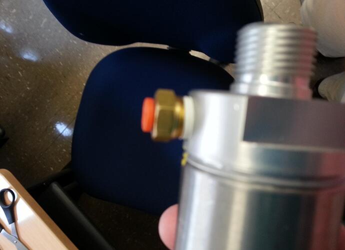

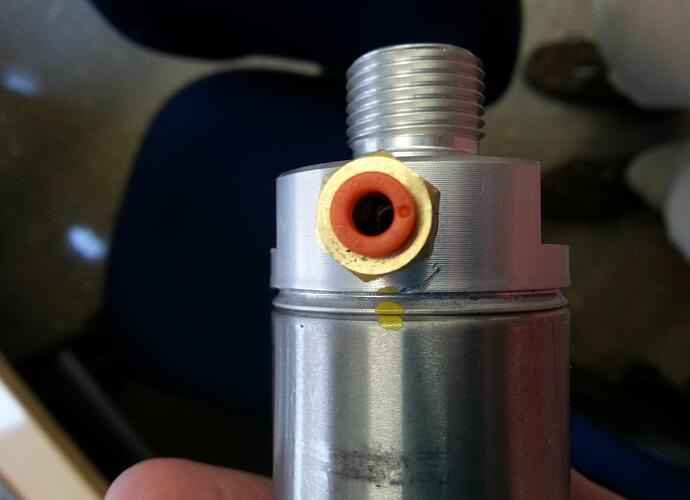

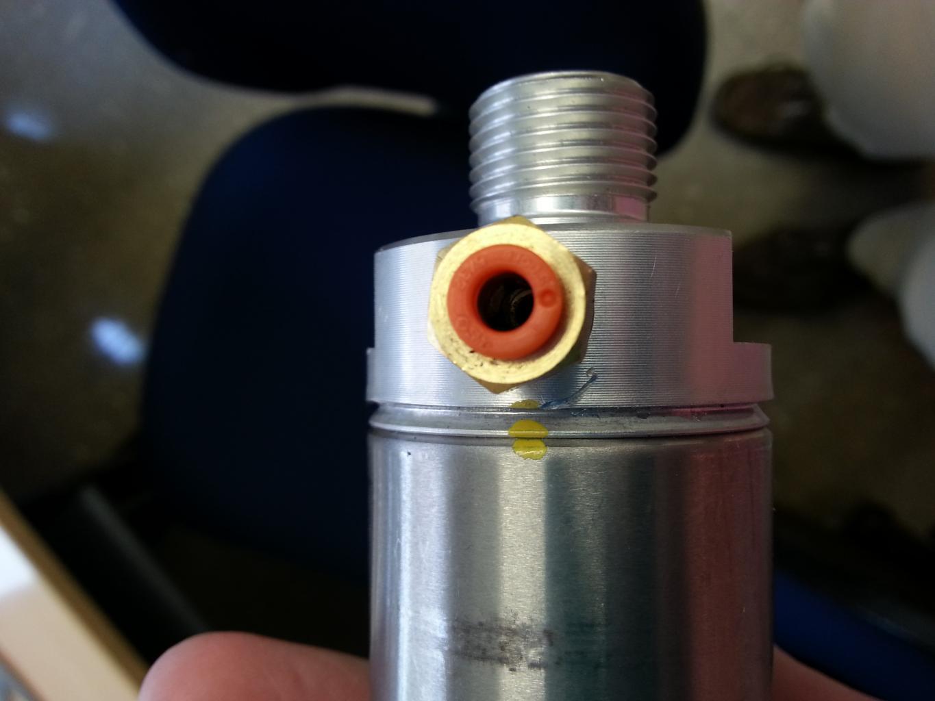

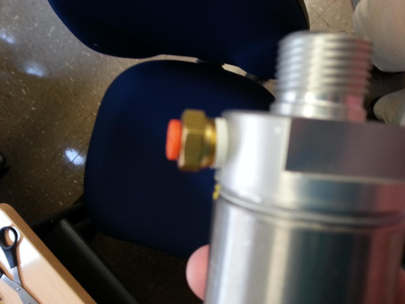

Our SMC distributor informed us that the fittings that VEX currently uses for their reservoirs, KQ2H03-34S, have been discontinued. We currently have an almost identical fitting, KQ2H01-35S, that serves an identical function.
Because of the shortage of discontinued fittings, are we allowed to use the newer fittings that serve the same function and do not provide any competitive edge?

I’m sorry if I sent the incorrect part number, I’ve attached pictures of what we use. They have the same thread count and size as the vex fittings and connect to the same size tubing via the push connector. We have found that they are just as reliable as the fittings provided in the pneumatic kits. The only difference we seem to notice is that they are slightly smaller. We just wanted verification that they were 100% legal before we put them on our competition bots.

The fittings in the pictures appear to be functionally identical, and therefore are legal.
The fitting with P/N: KQ2H01-35S does not appear to be functionally identical, and as such would be illegal.
