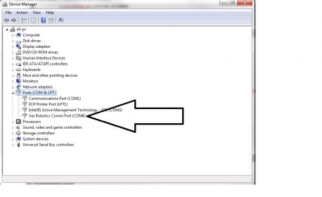

With your Cortex connected with the USB A-to-A cable to your PC, open Windows Device Manager and look under “Ports”
If your Cortex is being recognized by the PC, you will see listed “VEX Robotics Comm…”
-Eli

Eli,
Yes, it is being reconized by the computer.

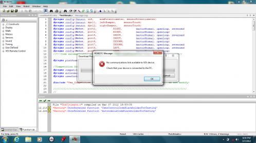

Eli,
We called Vex, and they made me download my code over the A to A cable. We can now connect my controller and cortex, but when we go to download code via the vex keys, we get whats pictured below.

3281a,
When downloading wireless, make sure you have the following:
  • Green VEXnet LED on Cortex & Joystick (indicates a solid wireless connection)
  • Hardware Programming Cable connected to “Programming” port on Joystick
  • Windows XP/7 Prolific USB Driver installed properly.
  • If using ROBOTC, please select “Cortex 2.0” under Platform and “VEXnet or USB” under VEX Cortex Communication Mode.
