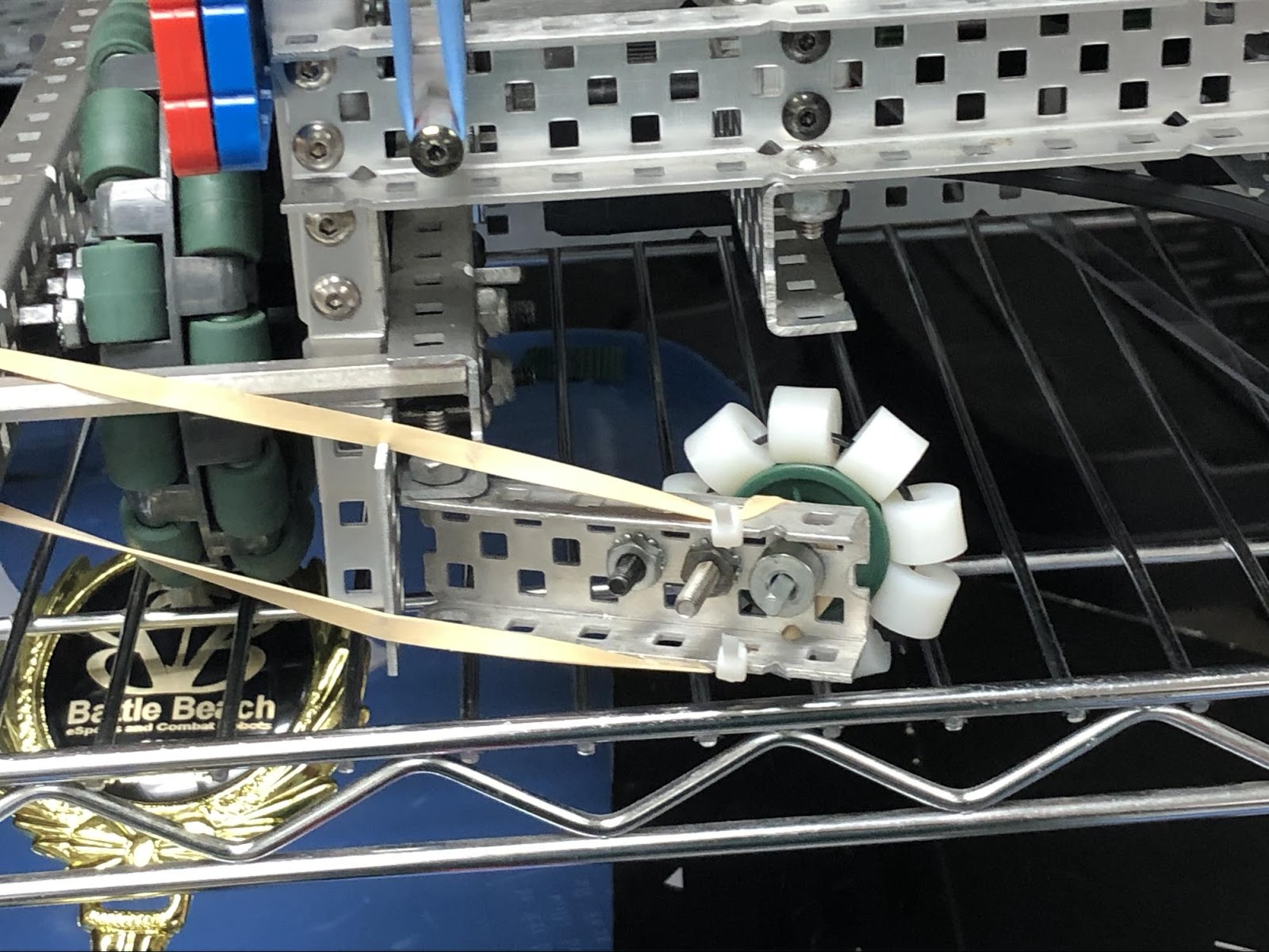

Robot has a folding tray that can stack seven cubes but often starts To tip over backwards when we have 5 cubes on our tray. Just want ideas on a way to add some support on the robot in the back?

our sister team used fold out wheels and they work really well. They don’t use regular wheels though, they put a zip tie trough spacers and put it around 2 45 degree angle gears. I will get a picture asap
Thanks. Picture would be nice
I hope these help
