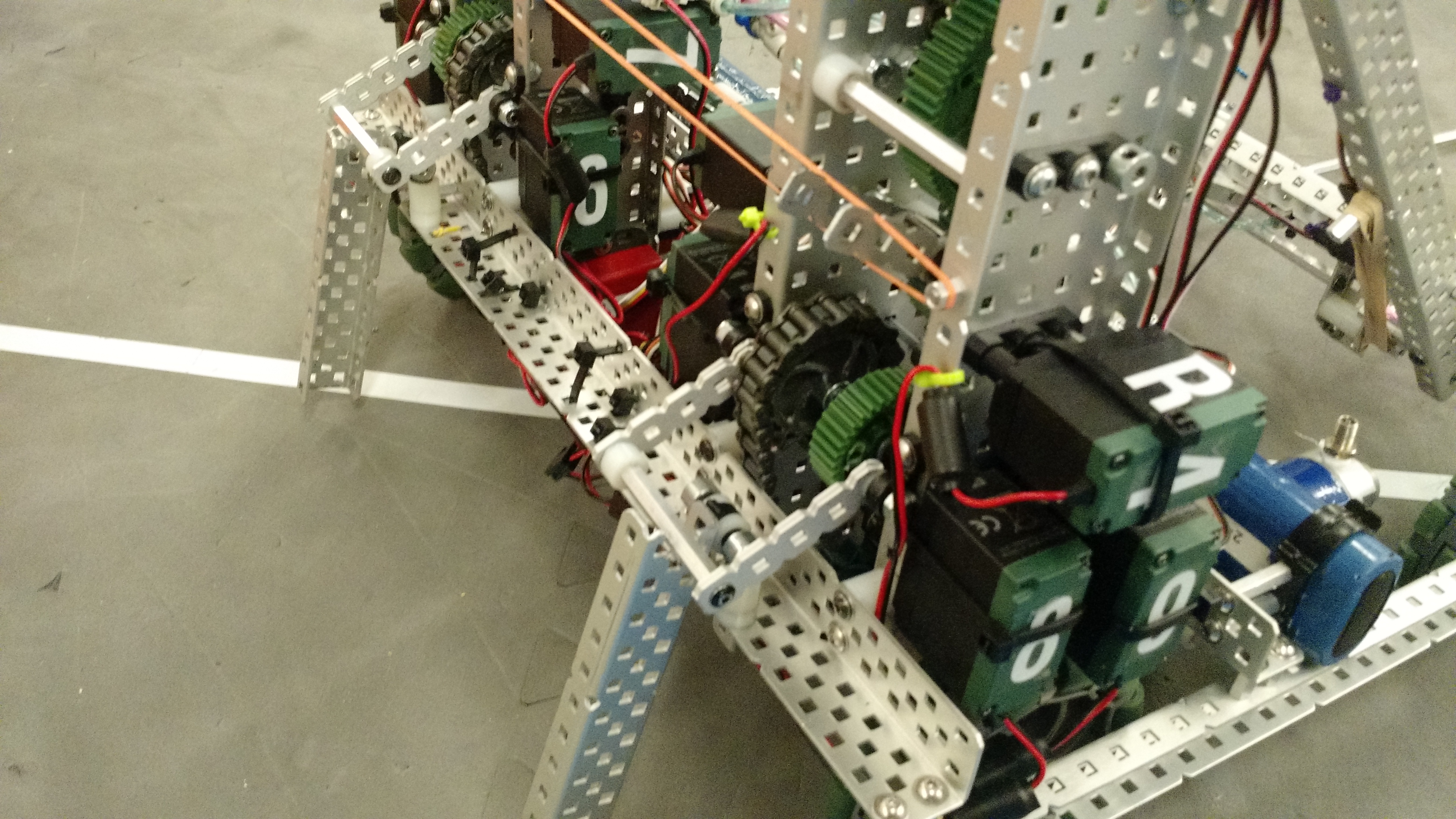

Hello all, today i was working with my robot (as always) and my team suggested adding antitips, however the way our robot ends up hanging is through the normanl reverse dumper 180 hang. Howevet with standard antitips this doesnt work, and the back end of the robot angles downwards and the antitips catch and prevetn hangin. I would like to know if anyone has fixed this problem before, or if anyone had any ideas that they could add. Thanks in advance-9065parker

Ok, i found a way that works really well, is passive and doesnt require almost any space

It works really well, folds up straight and is passive, you can hang with it to

Ill grab better pitcures tommorrow, however for now its 2 standoffs mounted onto the back of my robot by using rotational bearing flats (attached) and they hook up into my gear that runs my lift, on the gear theres a small hook that holds it in place at the beggining of the match, then at the start of the match whenever the gear moves down and the arm up, the hook disengages and the rubber band pulls the assebly down to where its held in place by the rubberband, and held open by a c channel

Works very well, i cant tip anymore, and can hang well
This is what we used. It’s a similar concept, but we found using just rubber bands wasn’t enough to really prevent tipping so we used a lock instead. The c-channel and the 1x bars fold up at the beginning of a match and fall down when we drive forwards. The standoff connecting the aluminum bars locks the c-channel in place by falling into a notch we cut into the c-channel.
