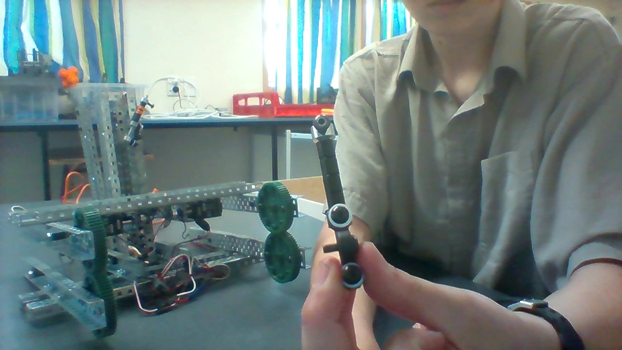

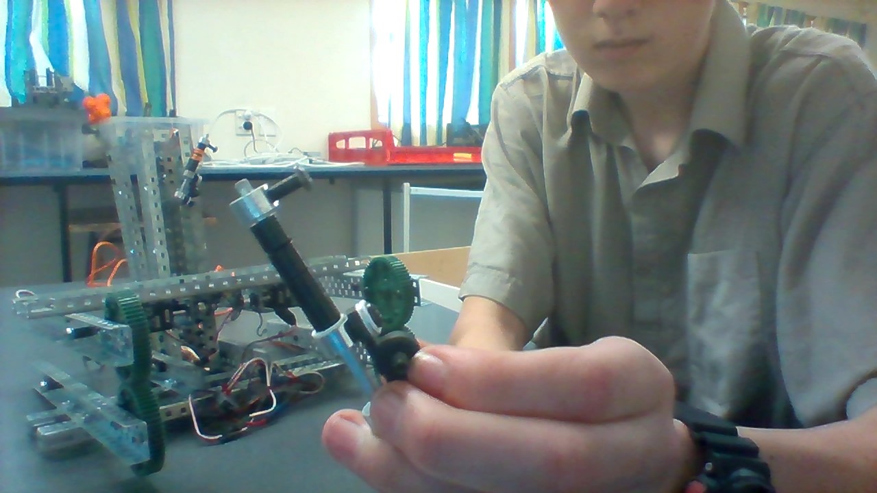

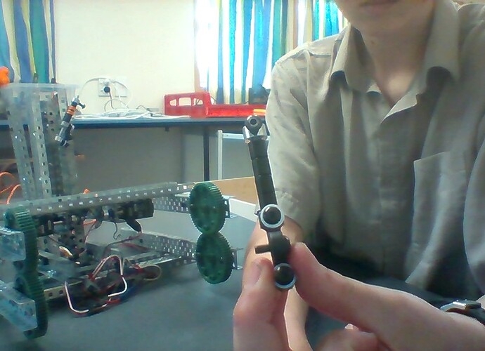

@Juster We have similar budgets issues and we found a really good lock, we have a arm that folds out and we only use rubber bands to unfold it, i can upload some photos in a few hours and the lock is just made using a shaft and some collars.
That would work we have all those parts available at the moment. Thanks @optic
forgot to get the pics should do tomorrow after school sorry. correct me if im wrong but i take it your arm is folded at the start of the match and then unfolds during the match?
Yes that’s correct
Here they are @Juster sorry about the fact that nothing is connected but hopefully you can see how it works, i will attach a video of our auton from last comp to show u how it works in the comp. Had to upload to youtube because it didnt recognize video format. - YouTube
Thanks that works but our bars are way apart so maybe a different lock mechanism would work better
@Juster can u attach pictures of your? that would help us to help you.
