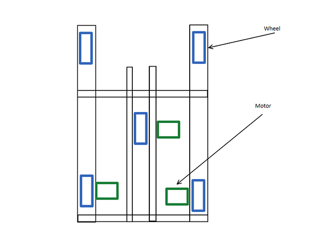

Someone I know did something like this… (NOT AT ALL TO SCALE) made it in about a minute with Microsoft onenote.
(the front wheels are chained with the back wheels for power)

Does the center wheel have to be in dead center of the base to work?
And how can I program tank drive for this wheel set up?
Thanks
I use that type of design on my robot and I have my middle wheel in the back of the robot. It doesn’t effect performance (that I noticed). My code has the middle wheel set to an average of the left and right joystick value so it’s (right joystick value + left joystick value) / 2. I can show you my code if you are confused.
It can be in the back or front but if it is shifted right or left you have to power it to account for when the robot rotates, which you’ll want to avoid
Adding on to @Deicer, make sure that you have the center wheel on the same plane. This is a major problem for many teams, as the middle wheel is slightly higher or lower than the other 4 or 6 wheels, causing it to render practically worthless.
