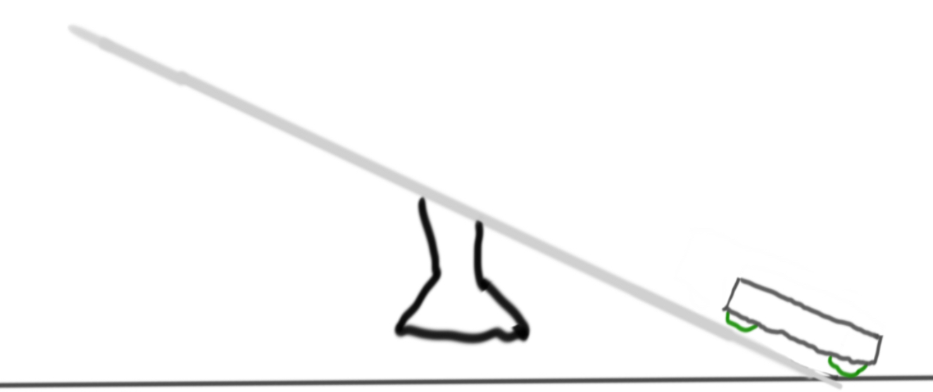

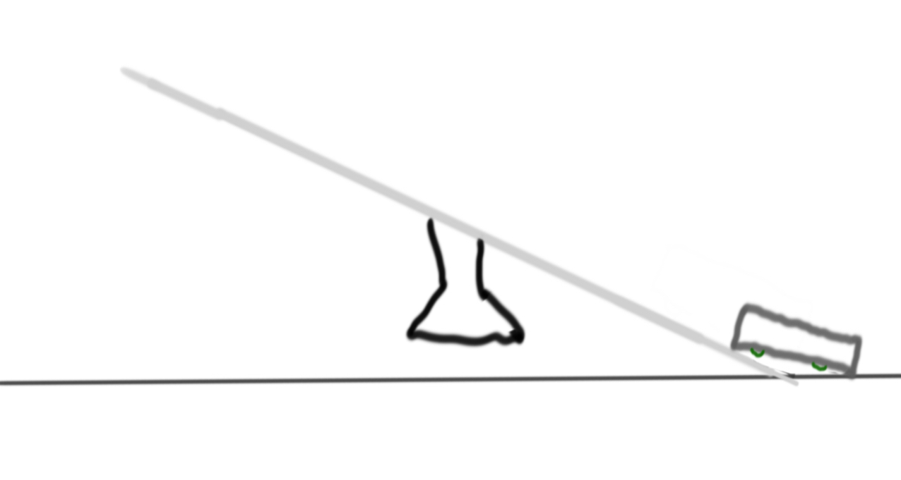

Do you have enough ground clearance to get onto the platform? If you have a 6 motor drive I highly doubt its an issue with power/torque. Make sure that when you are climbing the platform you aren’t scraping the ground as you try to get on it, or running into the platform preventing you from getting on it.
I know these drawings are bad but they are just to give you an idea of what im talking about
This will make it so you cant climb:
This will allow you to actually get onto the platform:

or cutting a small angle in the front, to give clearance.
I was mostly just giving examples of what might be happening that would stop them from being able to get on instead of offering solutions but thank you for posting this, I should have mentioned more solutions.
