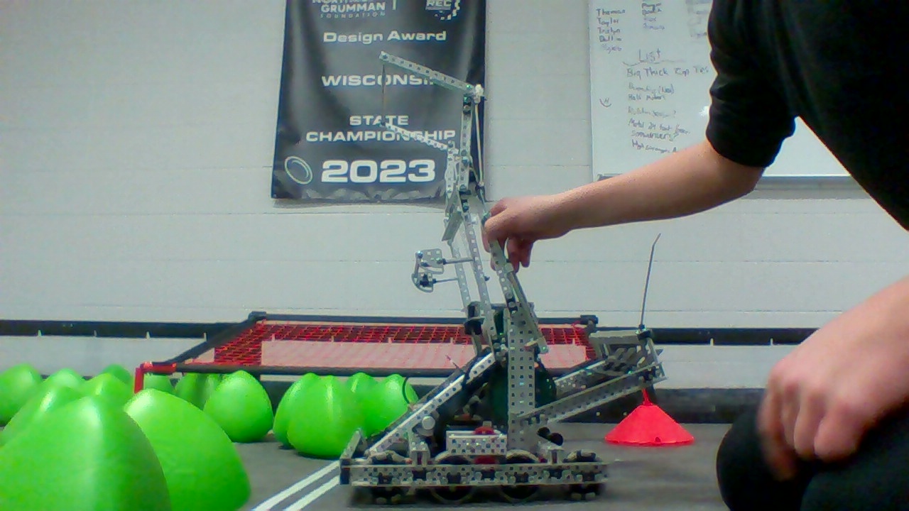

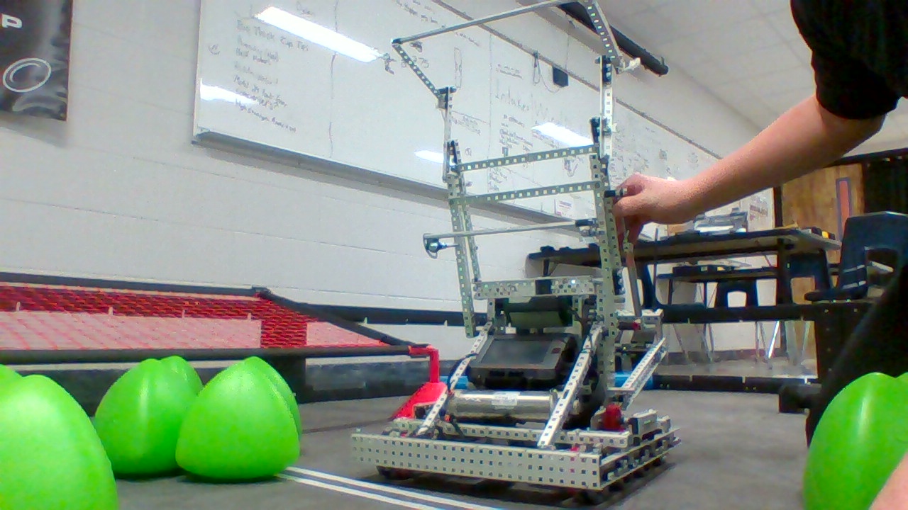

We have a 4 bar blocker, ya know what, here ill just send a pic:
