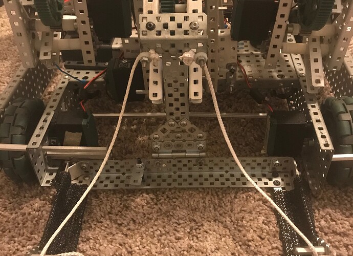

Ok, so I have to build a passive intake for our bot and I have to use no plexiglas, because we don’t have any on us. Does anyone have any designs for me? We are getting desperate.

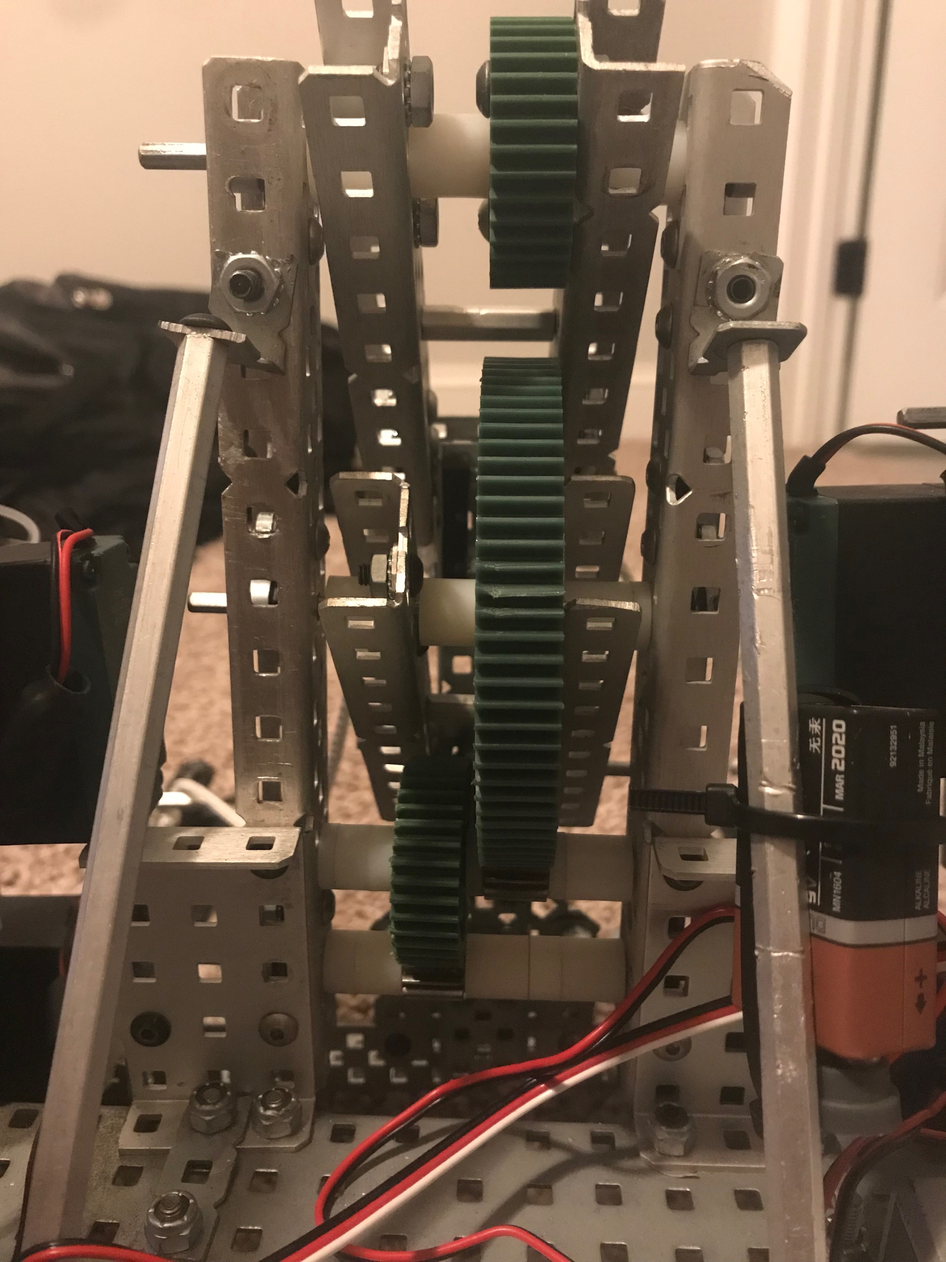

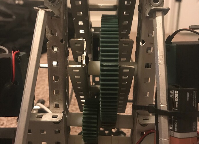

Pleaseeee done to a passive. The best route for a mobile goal lift is 1 high torque motor lifting a forklift with a 1/10 gear ratio (82:12 attached to 36:12 gear ratio)

Just use c channel with a bunch of zip ties. I’ve seen this idea work best when the intake is shaped like a c from the overhead view.

I prototyped one. I just took a regular claw, put zip-ties on it, put one set of standoffs on green joints, and poof. Wasn’t too hard
Why so much gearing? I have teams using 1:7 and planning on switching to 1:5 with 1 motor using a high speed motor on a 4 bar. Middle school team with driving skills of 104 while using only 7 motors total. They are now using 10 motors and should be able to increase that number.
In a competition last week, they put a mogo with 4 cones on it in the 20 point zone to get the high stack bonus. Not sure why you need a 1:10 gear ratio.
Here’s a vid of something like this that I made awhile back. Like @NightsRosario it’s really just a normal claw that I took the motor off of and slapped a rubber band on(I literally used it with a motor for a competition a few days before that).

You could use the type of zip tie intake my robot has in this video (which I post because it is super visible).
