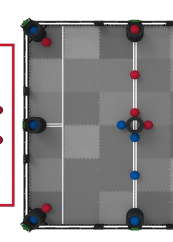

So right now our org is running a 12x8 field so it looks like this.
It works pretty well and haven’t run into problems yet. It’s little more cramped than usual because we store bots on the field, but that’s an us problem. Change up is probably one of the few games where this would work.
You’d be running this:
And I’d say it would be pretty good. cause you should be able to do everything.
