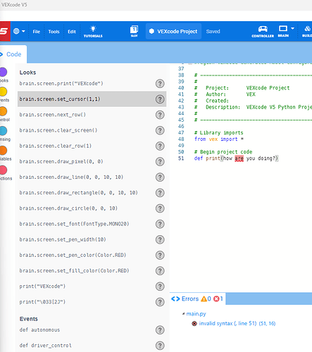

Anyone Having problems with the vex v5 python?
I am using python in the text code option and i am running this command “def print(How are you doing?)”. Then I click Build but it says that “are” is a invalid syntax.
So that’s invalid Python.
This code is not valid Python. I would suggest watching a tutorial like this one here https://www.youtube.com/watch?v=b093aqAZiPU to get a grasp on how to program in python
As others have said, the syntax is incorrect. To use the print function, don’t put the “def” in front of it. That is used to define you own function. To print text, use this:
print("whatever text you want")
Make sure you yse the double quotation marks because that diffrentiates the text inside the parantheses from a varible (without the quotes) and normak text (with the quotes)
I hope this wouks!
Just some extra python clarification:
def is used to define a function. E.g. if you wanted to define myfunc with parameters/arguments a, b, c, etc, you would use def:
def myfunc(a, b, c):
  pass
You don’t need quotation marks when you are showing args, but when you want to pass a string to the function, that’s when you use quotation marks.
Also, after you run the code, you might not directly see the output on the Brain because that requires brain.screen.print(“how are you doing?”).
