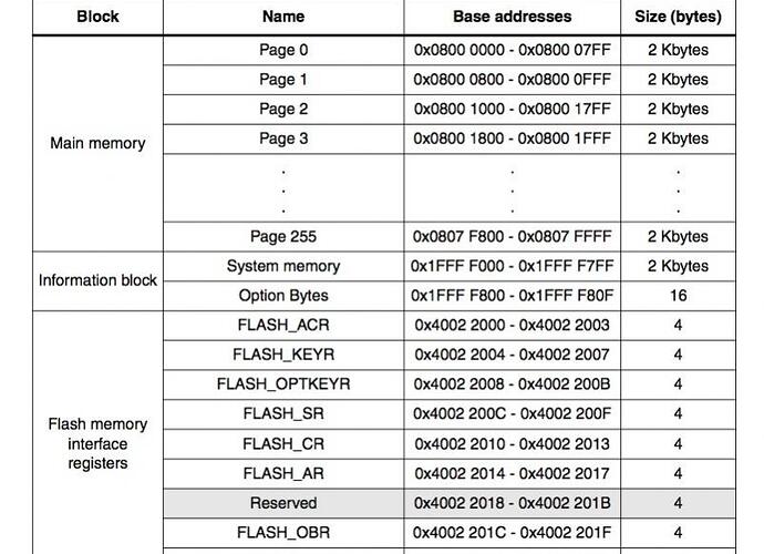

Didn’t mean to be picky, just wanted the correct number published. Here’s a picture if anyone is interested.
[ATTACH]5605[/ATTACH]
Not a Problem… You NEED to be Picky, I don’t think Processor STM32F103VD46 exsists, but if it did, People would get the Wrong Documentation…

One thing you could do for development would be to buy an eval card for the STM32, it would not run EasyC code properly (perhaps not at all) but you could get the flash library built without any potential damage to the schools cortex.
One candidate could be this. There are others in the $30-$50 range.

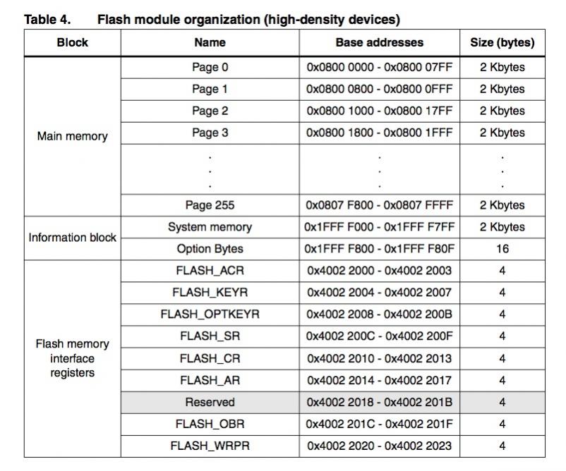

I don’t actually think it will be that hard to get going, the flash starts at memory address 0x8000000, for ROBOTC (in the latest versions) the VM is in the area 0x8000000 - 0x8018000 (64K), the ROBOTC filesystems is after that and is where user programs are loaded. For EasyC I assume they just load code starting at the beginning. Here is the flash memory map from the datasheet (which if you don’t have then download as it has all of this information). Only 192 flash pages for the STM32 in the cortex, I would use high memory so new program code should not overwrite it unless they perform a complete flash erase before download.
For flash reading you should be able to set a pointer to the address you want and read away :slight_smile:
[ATTACH]5608[/ATTACH]
Thanks for that table! I’ve been looking for it forever (in the wrong places obviously xd) I haven’t been able to find the datasheet either - but now that I know which device we are using I imagine it is much easier to find.

The “Table 4” that jpearman posted previously, appears to be from an Older Version of the “Reference Manual”… It Is Now, Table 6, on PDF page 56…
