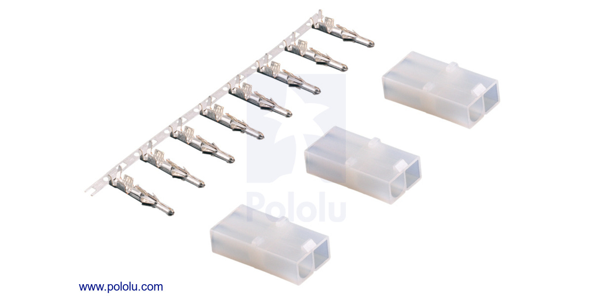

For those wanting to make an extension cable anyway, these products will get you started:
Connectors:
http://www.pololu.com/product/1932
Wire:
http://www.pololu.com/product/2652
http://www.pololu.com/product/2650
Crimping Tool (if you need one):
http://www.pololu.com/product/1928
