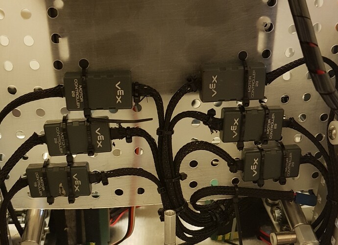

Would it be legal to use braided nylon sheathes for the cables? I would guess so, under nonfunctional decoration, but I’ve never seen this done before.
They are legal, I’ve seen many teams use them to organize and manage cables.
From the Robot rules
So if this braided nylon is commercially available, you may use it for the sole purpose of bundling or wrapping wires and cables…
Yeah, they are legal as they come under R7J and may only be used for wiring purposes.

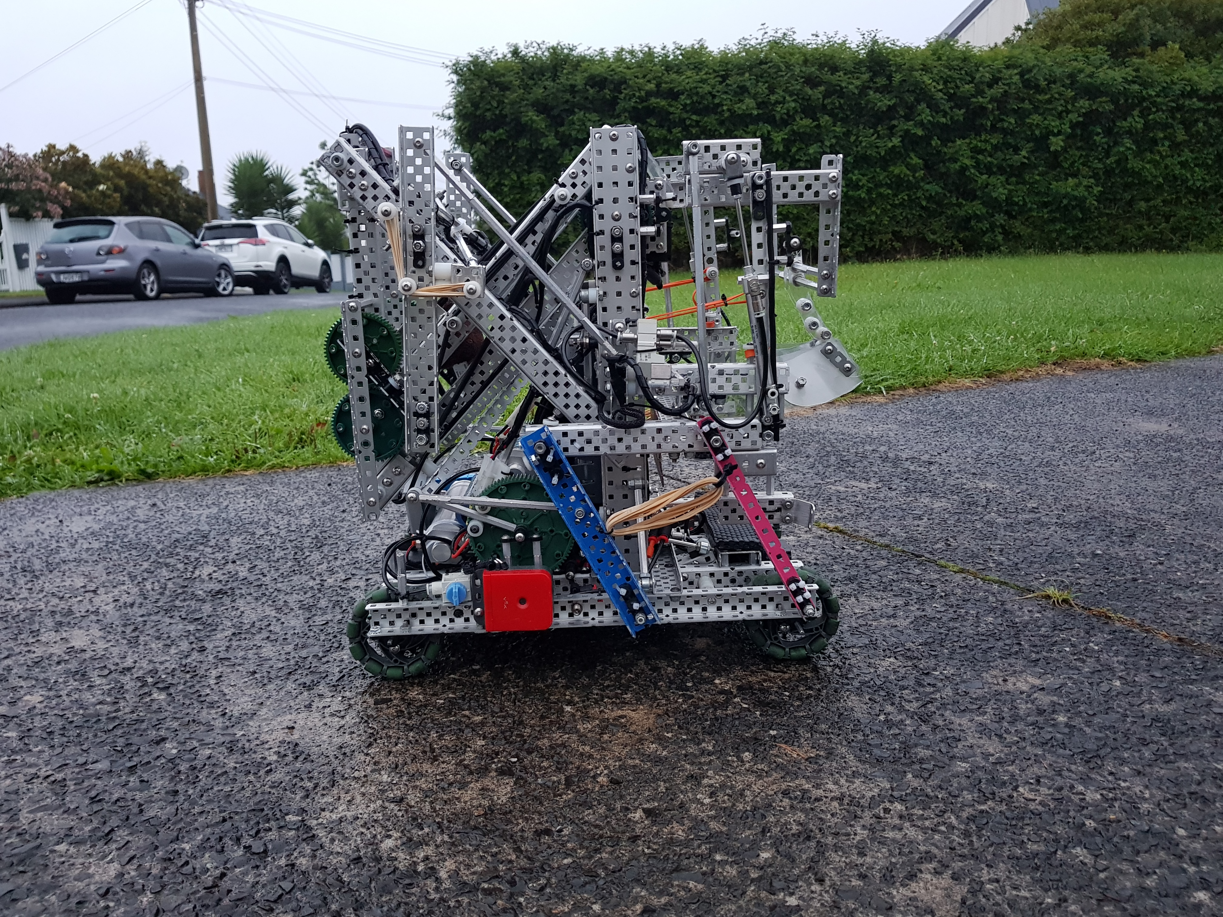

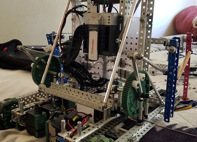

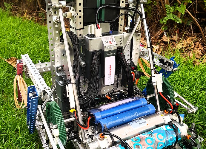

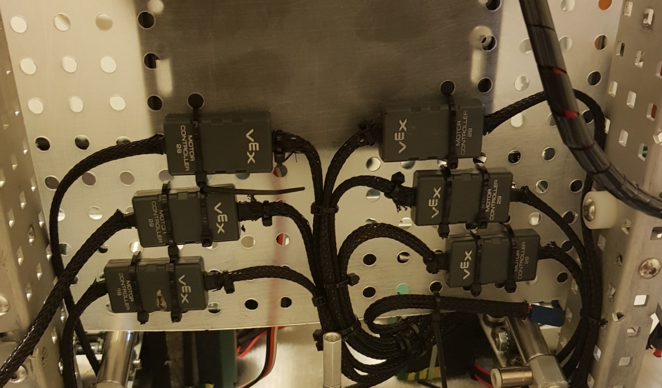

Here are some examples of their use.

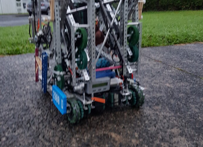

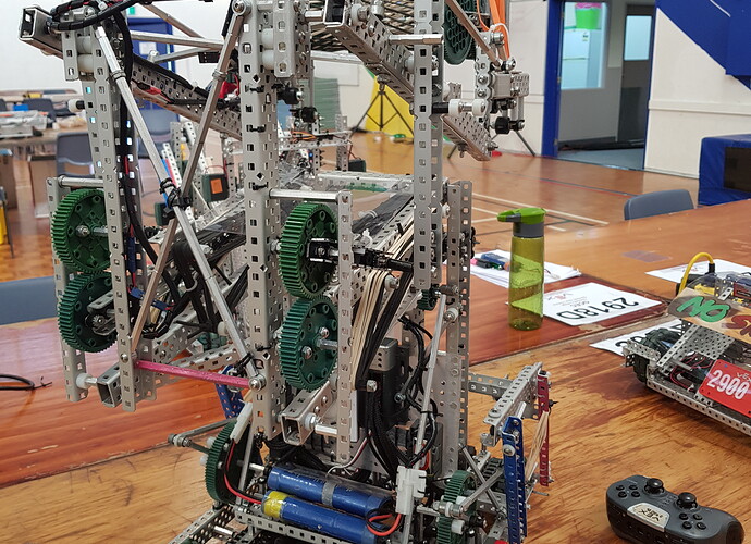

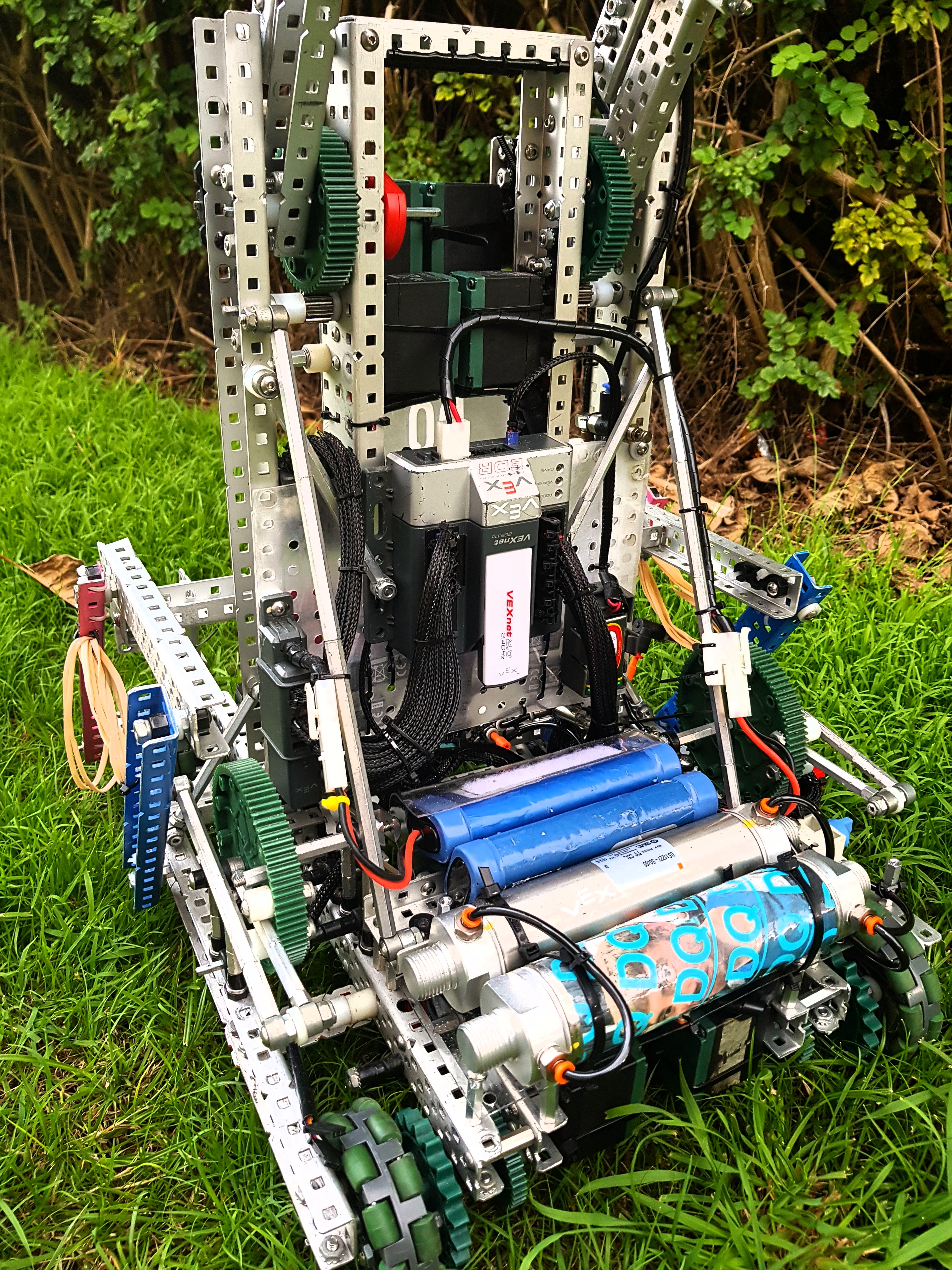

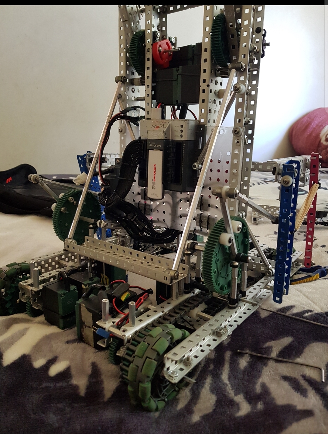

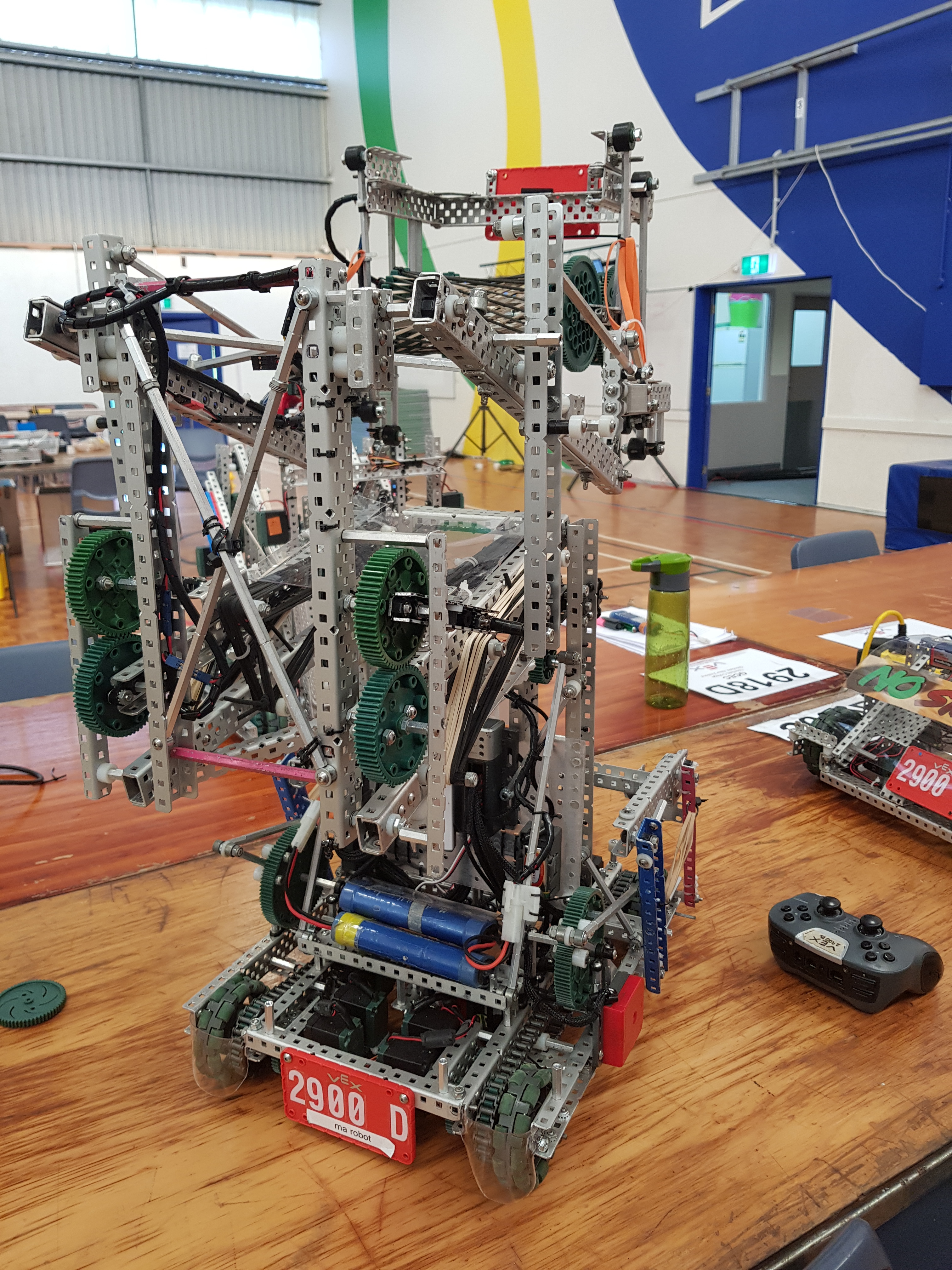

leeks

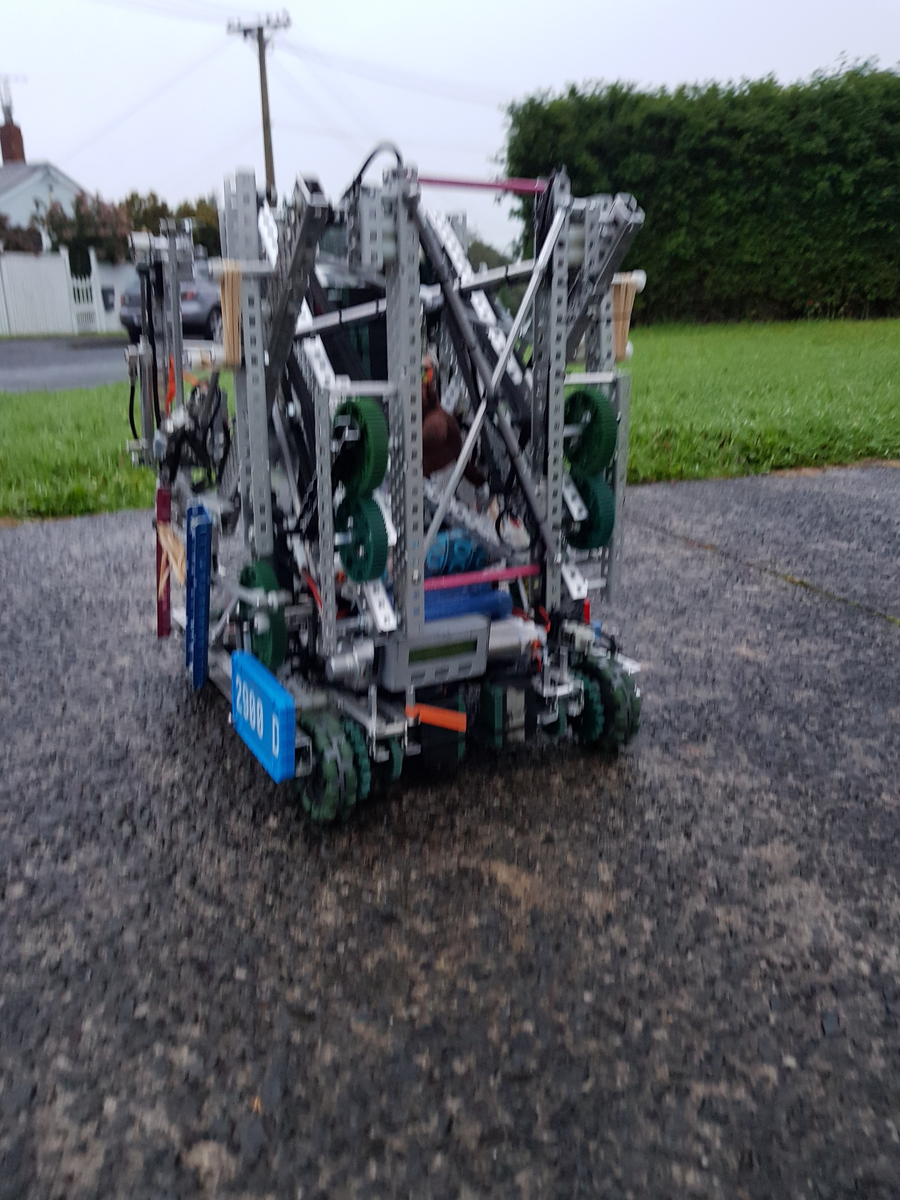

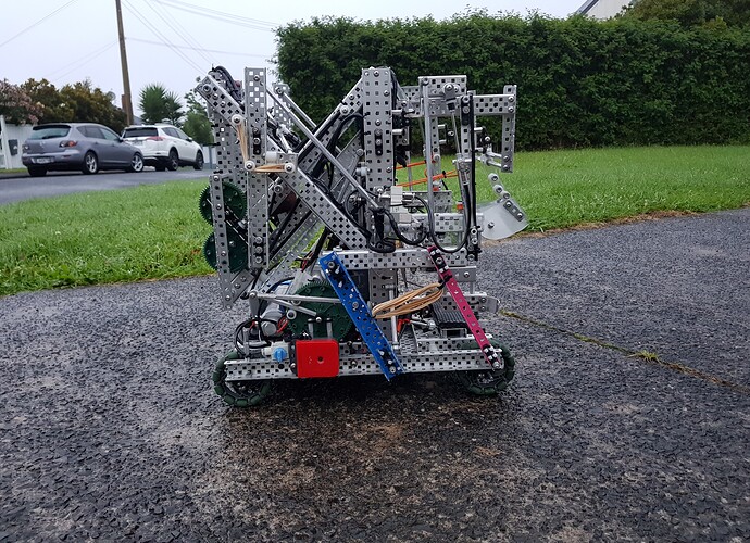

That is the smallest drive size I’ve ever seen on an internal stacker… Whoever made that is amazing.
it’s 25 wide and @proto made it. I still ree at him for the 25-wide, but the robot is a snack
It gets even better…
