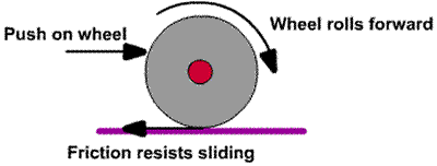

Sure there is some friction loss but an ideal wheel is supposed to free spin with minimal friction on the axle and maximum friction between the wheel and the ground. The static friction between the foam field tiles and the rubber rollers is more than enough force to cause the tracking wheel to spin.
Not to mention the tracking wheel should be pushed down into the ground with elastics further increasing the force of friction that causes the wheel to spin.
Here’s a diagram that I think will be useful:

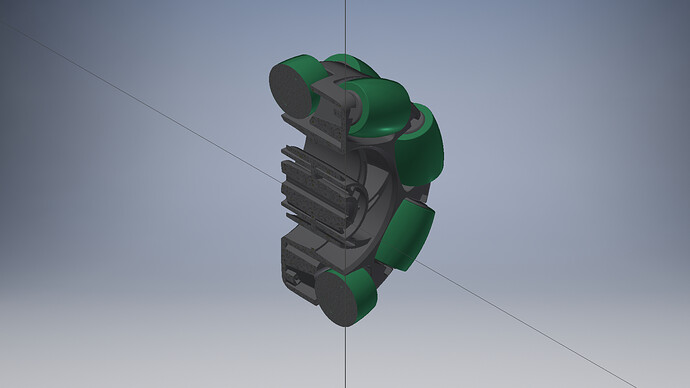

The issue is that with a half cut omni, it is no longer a true wheel. There are significant gaps where the wheel diameter is smaller, and will absolutely result in slip that leads to noticeable drift in the odometry.

I think the point is that the rollers in each half are offset alternatingleft and right. With just half, you have large alternate gaps where the other halfs roller would have been and so has a lot more flat sides. The single style dont suffer this issue - they have something like 14 rollers around the circumference. With the 2.75 cut in half, you end up with 7. When it is still whole, the offset rollers still give 14 round the circumference.
2.75 inch omnis have staggered rollers such that there is always a contact point on the ground. Half of these are on each half of the wheel. Therefore, by removing one half, you remove close to half of the wheel’s ability to contact the ground, creating the issues described.

This isn’t true. The rollers on the 2.75 halfcuts are quite large, meaning that the divots between them are quite deep. This means that even with bands, the areas where there is no roller will not touch the ground, causing the issues I mentioned.
