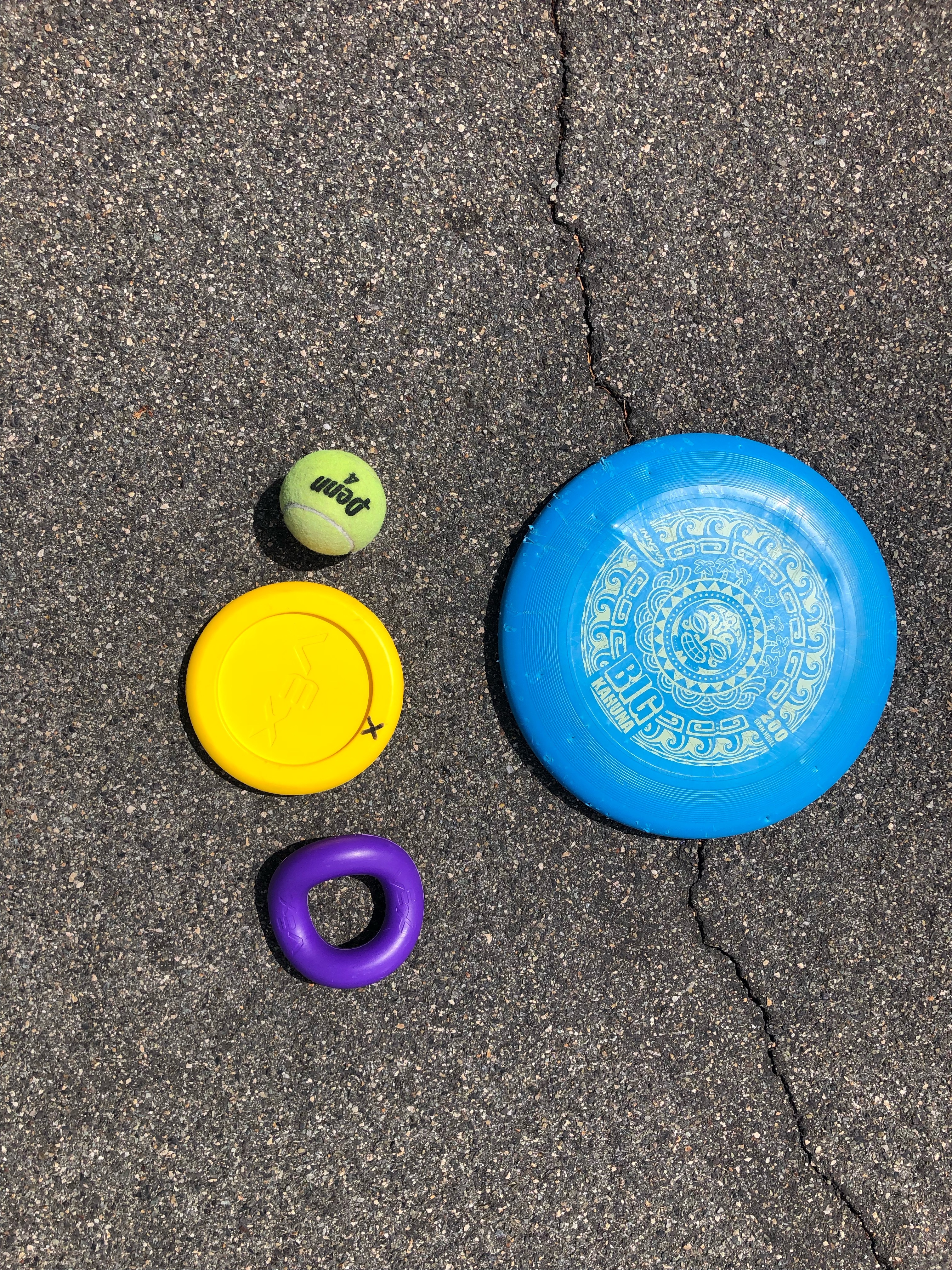

We recently got foam discs for spin up. After some testing, it became apparent that these are not frisbees. They are symmetrical discs, which seem to generate zero lift when tossed through the air. We came to this conclusion through a few tests as well as some research.
We compared different throwing methods, and different objects to figure it out. We threw the discs in three different orientations: like a frisbee, vertically, and like a catapult. We compared these throwing methods to a tennis ball and frisbee. When comparing different objects we tried our best to throw them in the same way and took some notes on the movement of the objects.
The same person at approximately the same power for each throw.
  • We threw a disc and a tennis ball in the way you would throw a frisbee, and they approximately traveled the same distance. The disc was stable while it was spinning, but did arc, while the tennis ball traveled in a straight path.
  • Throwing a frisbee and a disc with a frisbee throw resulted in the frisbee going MUCH farther than the disc.
  • Comparing the disc to a ball in an overhand throw(see fig 2) resulted in the disc being slow and not traveling very far while the ball moved in a parabolic trajectory.
  • Throwing a disc in a vertical orientation(see fig 3) in an overhand throw results in the ball going further than the disc. I think that the way we through this one compared to the ball is a bit different because it’s weird to try to flick a ball.
  • Throwing the disc underhand while flicking the wrist(fig 4) made the disc go further than the ball, but this might just be the fact that the flick of the wrist is easier for the disc than the ball.
  • Throwing a disc and a ring like a frisbee resulted in them going approximately the same distance.
Pictures
Figure 1: All thrown objects.

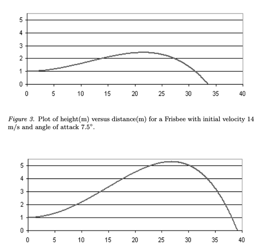

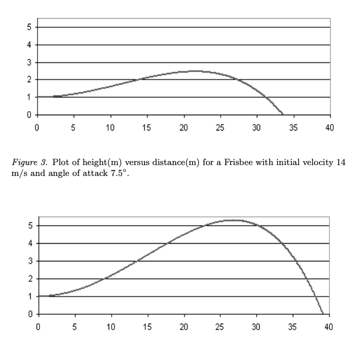

Well said, the discs do behave similar to a ball being thrown. However, it is important to note (and this is something that was brought up in the other thread) that an angle of attack (which causes lift) does develop as the disc is thrown because the heading of the disc’s velocity vector changes.
However, with light, small foam discs like the ones we are using for this years game, this effect is barely noticiable over short distances, especially to the human eye. If you look at the final graph I posted you will see that it varies slightly from a parabola. However, I suspect that if discs are not being launched quickly, and are not being launched very long distances, this affect will remain largely un-noticed.
In Summary: The aerodynamic affects of a frisbee do affect the disc, they are just hard to notice,

Correct me if I’m wrong here but based on these pictures, it doesn’t seem like you threw the discs horizontally like you would a frisbee. If that is the case, would it be possible to test them in that manner? Also do you have (even qualatative) data on the flight path of the discs as compared to the tennis ball? With minimal drag, the ball should travel in a parabolic path. (As the kinematic analysis I did modelled) Was the disc at all similar to this? Was the disc flight path similar to the frisbee fight graphs (below) shown in the MIT Paper originally shared by @LastMinuteFix ?

The tennis ball was picked for a few reasons similarity in size as well as weight. I just looked up the weight of a tennis ball and Google says it’s about 56 grams which are comparable to the ± 10 grams for the 65-gram discs.
I did throw the discs horizontally like a frisbee. The pictures were there to the other methods of throwing that I tried were more difficult to explain or visualize.
The qualitative data is what I observed when throwing the discs. My perspective was as the thrower, but I was able to compare where different objects landed. The disc flight path did not seem to mimic any of the graphs that you showed, I will likely do more tests with more ppl to help take down better data.
As far as I can tell the discs and the ring flew in the most similar way from my viewpoint, and both landed at approximately the same distance. I will likely do more tests with more ppl to help take down better data.

So I got to playing with the discs as a frisbee during lunch today. You can throw the discs like a frisbee and they can fly very far. Now the discs don’t seem to mimic the graphs of the frisbee(go up with lift) but they seem to fly further than what would be expected with a parabolic trajectory.
My hypophysis is that because the disc was spinning it there was air resistance on the bottom of the disc making it fall slower and fly for a longer time.
The reason the disc is falling slower, and therefore flying further, would be because of the angle of attack that develops as the heading of the velocity vector changes, and causes lift.
It is important to note that spinning the frisbee provides it gyroscopic stability, it is not what is directly inducing lift.

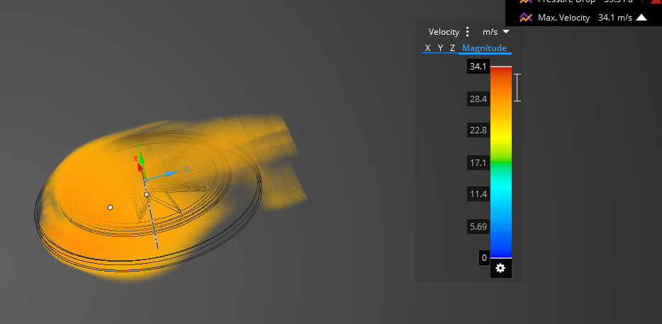

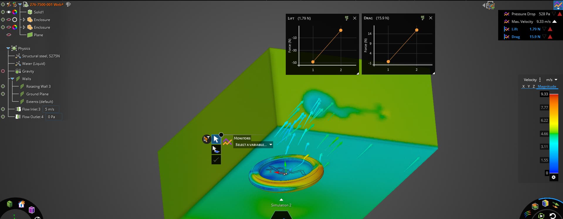

Useing Ansys Discovery fluid simulation I have simulated both discs and frisbees to better understand the dynamics and to really answer the question of how much lift does a disc have. Now for the purpose of this simulation the primary independent variables are angle of attack and spin of the disc.
Unknown
For a disc with a angle of attack of 0 and no spin flying though the air at 20 m/s we get something like this.
This x axis of the graphs are changes that i have made to the simulation. Thoses changes are increasing the velocity of the air. Starting at 0.05 m/s, then 5 m/s, 10 m/s, 15 m/s and finally 20 m/s.
We can see that the lift decrease as velocity increases and the inverse for drag. The graphs here really highlight the expontional nature of air resistance.

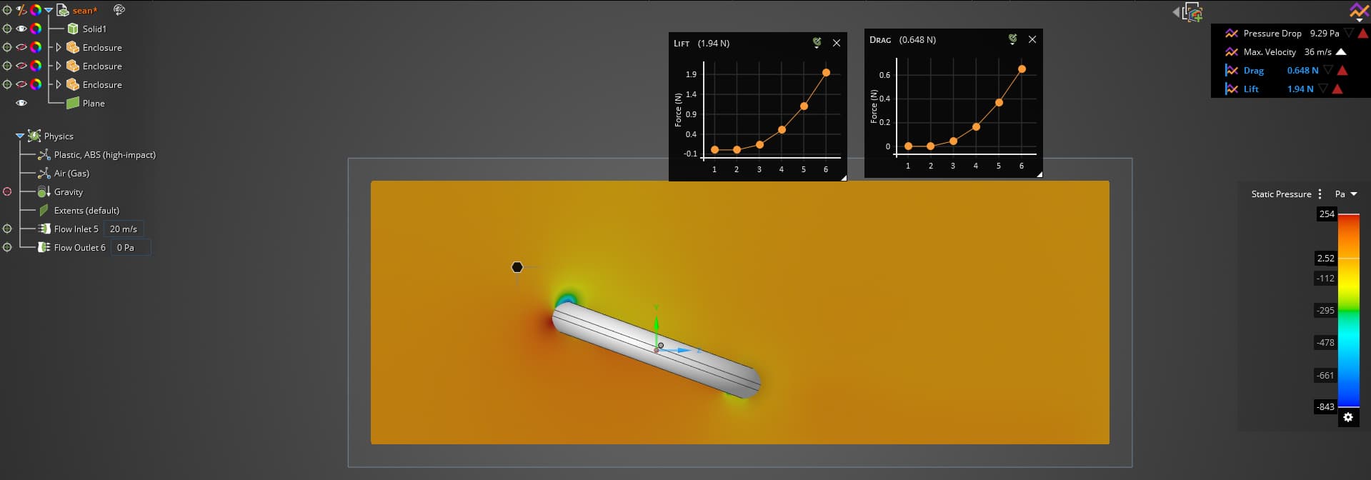

This picture shows the pressure around the disc with an angle of attack 20 degrees. This simulation doesn’t take gravity in to account, so the lift force that we see here is counted acted by gravity.
Fg = 9.8 m/s^2* 0.065 kg = 0.637N down. If the disc was traveling at 20 m/s (very unrelastic)
Now lets compare this to a CAD model of a frisbee that I found.
I don’t know anything about this actually firsbee its just a model i found. But we can clearly see the pressure differences on the top vs the bottom. The light blue low pressure and the orange red high pressures clearly indicate that there should be lift. This frisbee has 41.4N of lift force at a 20 degree angle of attack with 20 m/s flow. That is significantly more than the disc.
The fact that one can clearly see the pressure differences on the frisbee simulation compared to the disc simulation where there are small pockets of different pressures indicates that discs are not comparable to frisbees.
Now what hasn’t been taken into account yet is the spin of the disc and frisbee. Searching up how fast a frisbee’s rotation is we get a number between 3.9 and 6.14 rps, which 234 rpm - 368.4 rpm. As for the disc speed I chose a high value of 3000 rpm.
Adding the rotational comptantes to the simulation seems to change the rate at which the lift increases for the velocity, and not being as much lift. The caviat to this is the rpm is really high. The drag numbers for spin and no spin at 20 m/s are roughly the same.
With the frisbee simulated in the same conditions as before but with 300 rpm of spin the lift decreased to 26.5 N, but there is 4.5N less dragn on the frisbee.

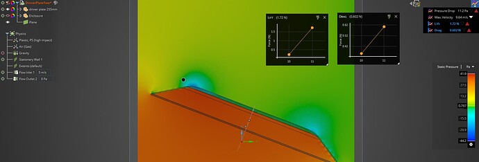

Plates
What are the dynamics of a random CAD model of a plate?
