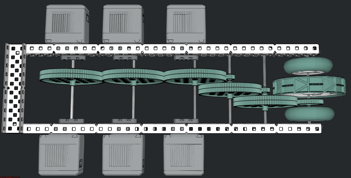

I am designing something fun with vex parts. Do you think four V5 motors are powerful enough to power a 147:1 drive train without over heating?
Well with the amount of gears/sprockets needed to get that ratio, I would assume the friction would build up significantly. However, if built correctly this probably wouldn’t be too much of an issue. Additionally, I feel like the acceleration on that would be really slow, so try to make it as light as possible. 4 motors might work, but don’t expect it to work for long. If it doesn’t work, double down and try 8 motors. I am terrified of what you might be doing…
So the gearing would be 12 tooth, 84 tooth, 84 tooth, 36 tooth, it would have lots of torque, but not much speed. Do you mean 1:147
I’m going for speed here. The idea is to build up speed while the wheel is in the air, then drop it at max speed.
I multi speed drive train would probably be better here, the motor would probably be fine spinning at that speed assuming that you use the standard 200 RPM cartridge to spin a wheel at the end, however it would probably have trouble getting started, at perhaps the 1:3 part of the system, you should add a lever which you can spin by hand to help it build up speed
So If I the motors had 100 RPM cartridges would this run for maybe 30 secs?
The two small wheels are just flywheels.
If you use the 600 rpm cartridges and take out a stage of gears, it would run slightly a little slower, but a little longer and with much less friction
Okay, lets do some math here. Assuming you are using a torque (100RPM Red) gear cartridge, this ratio would yield an end wheel velocity of 14,700 RPM. For standard 4in wheels that would end up putting your robot at ~175mph. Impressive.
However, there is a cost for such speed. Multiplying your torque by 1/147 yields, for a gearbox with 0 friction, 0.057 Newton meters at the output axle. Converting this to in-lbs give us 0.5 in-lbs. Divide this by 2 in (radius of wheel) and we get a total pushing force of 0.25lbs, which isn’t much.

  1. Take off all bearing flats on motor sides, they will create more friction as the motors themselves are their own bearing flats.
  2. Do low strength gears as they have less friction.
  3. Don’t rely on a single C-Channel for cross support. Have multiple, and also do spacer screw connections to make it as structurally sound.
  4. Drill holes in the metal for every place an axle goes through. This ensures less friction
  5. Grease up all bearing flats utilized

Also since you are running the wheels up to speed and then dropping them on the ground, I would strongly advise watching out for shock loads, as the motors suddenly have a spike in loading due to hitting the ground.
Also you may want to invest in full body armor, a helmet, face shield, and some riot shields as well as some excellent insurance. Not joking, stuff going that fast can do quite some damage.
As a matter of fact, I would not even drop the robot onto the ground, as any slight disturbance at those speeds could be amplified by the high speeds and lead to the robot pretty much breaking itself apart.
Your wheels will most likely not work at those speeds and will most likely disassemble. Expect this thing to be a one trick pony. It most likely will not run a second time.
Finally, keep in mind that it´s one thing to hit high speeds. It´s another thing to control those speeds. There´s a reason why 300 plus mph cars are so hard to make. I highly doubt the vex parts will be able to stand up to that much stress.

in the video posted by goofnrox if you go to the time 2:30 is will show you the axle and since vex uses steal axles its likely that they wont melt like plastic but more break because of all the force being on them at once so i’d advise you to use the thicker high strength axles instead
I may need a ratchet mechanism so I don’t destroy the motors…
