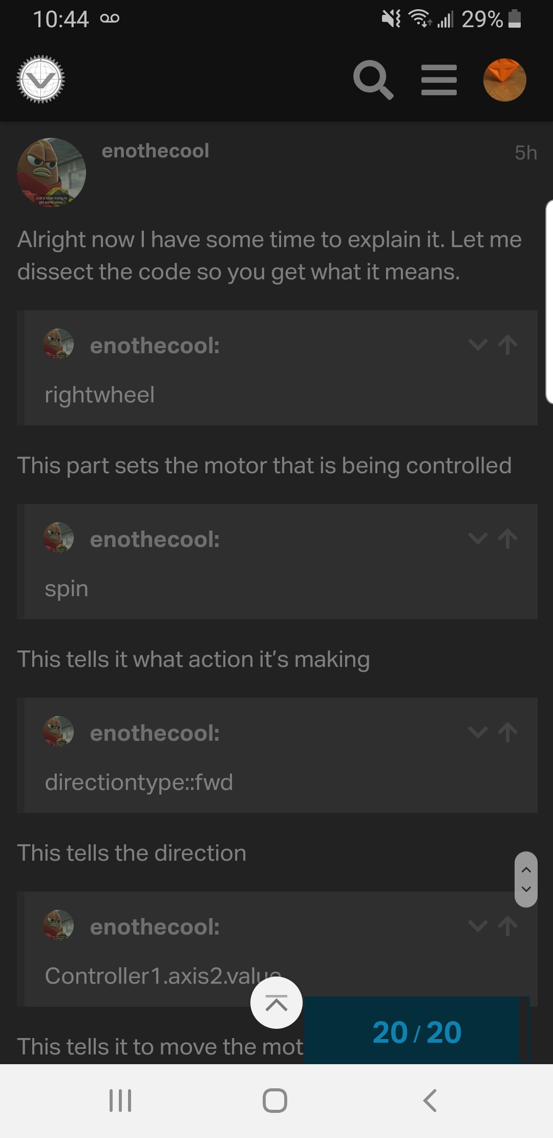

It occurs here too
@DRow
I think we have someone abusing the ability to flag posts. @enothecool created a perfectly relevant and helpful post and it was still flagged. Could you look into this?
Thanks!
