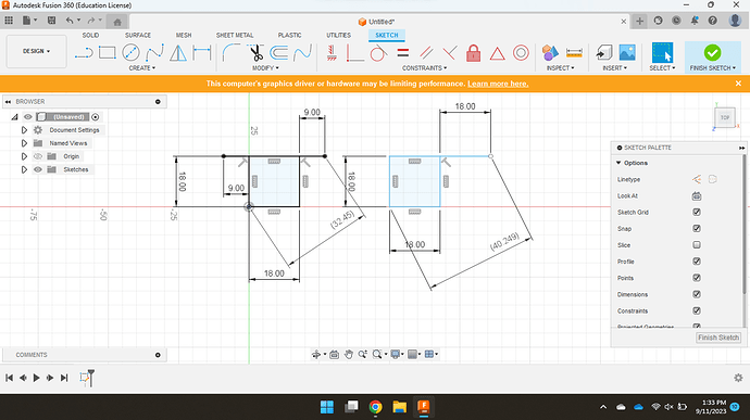

Just quickly, many people are saying that you can expand out once the match starts. That is true, however make sure to have no 2 points on the robot more than 36 inches apart.
I missed this in the rules when I read through them, and just checked again(SG2) Does this mean that the robot must fit within a 36" diameter circle?
Alot of people say that, but it is only a basic understanding of the rule. A robot with 36 in wings in the middle would fit in the circle, but not with wings on the front. Yet both are legal. A better way to understand would be that no 2 parts are 36 inches apart.

So, if a robot of size 18 expanded with wings that made it 36 in(9 in on each side), then from the bottom left to top right would be 32.45, this would fit within the 2-point limit. However, if they had only 1 wing that was 18 in long, the pt to pt would be 40.249. This second robot would be illegal.

That is correct. Glad to help!
