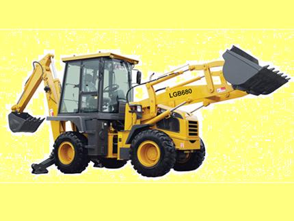

I dont see the point in holding a scoop in a claw, if you never need to let go.
Better to have the claw motor power another joint in the arm to control the scoop angle.
A backhoe prototype has 3-5 joints.
A bucket scoop can get by with 2: bucket tilt and arm lift. Its simplest if you can lift the arm completely overhead to be over the tray while holding the bucket level, then dump the bucket in the tray.
