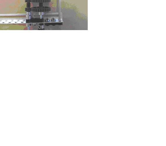

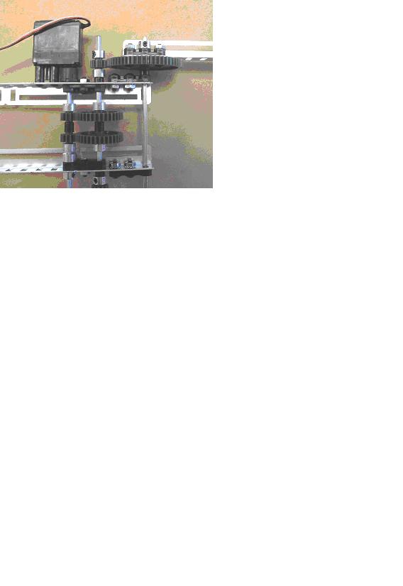

The other way to further reduce the gear ratio (slower & stronger) is to “ladder” the gearing using 2 stages. In the attached photo, the 12-tooth gear drives the 36-tooth gear. The axle with the 36-tooth gear also turns a 12-tooth gear (on the same axle), which drives the 60-tooth gear (the second stage).
The ratio here is:
(12/36)(12/60)= (1/3)(1/5) = 1/15 (15 times slower and stronger)
