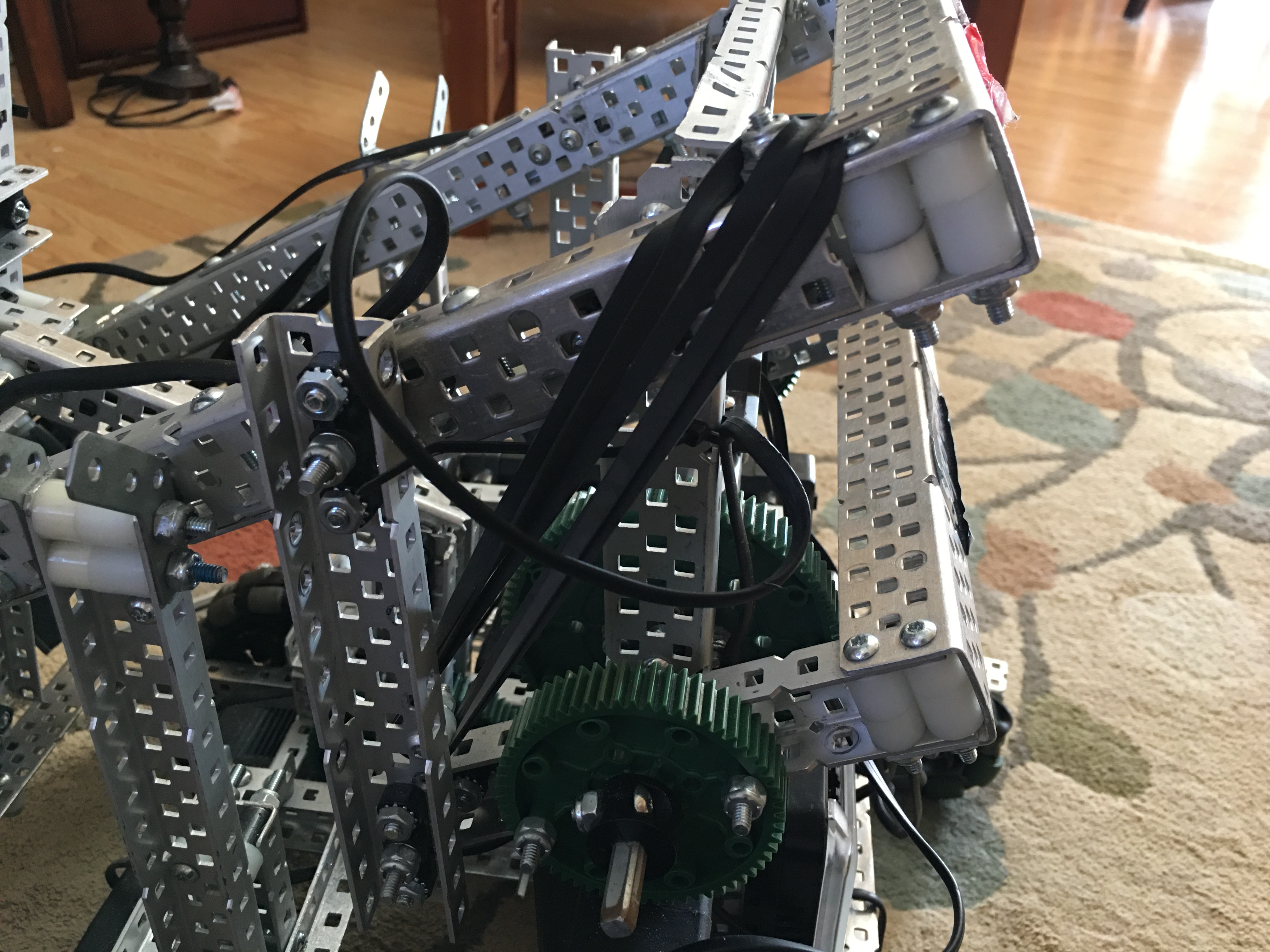

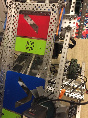

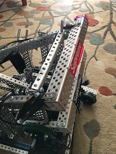

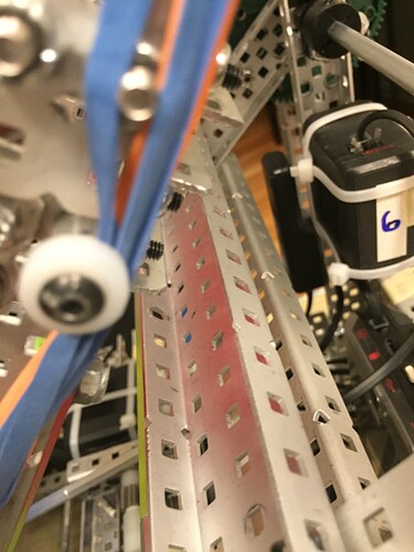

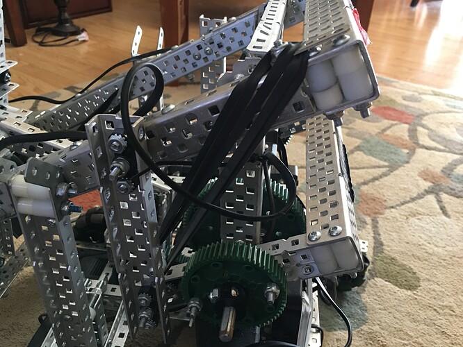

The arm of my team’s tray bot gets stuck easily (on the tray). How would I overcome/fix this problem?

I’m not sure if you can do it with your current design, but we solved this issue during a rebuild by having the arms stick out in the back by a couple holes so we can cross brace behind the towers. That way, when the arms raise, nothing rubs against the tray. You do have to compromise the height you can raise your arms somewhat, but we can still get the middle height towers. I can get pics if you want
Ok thanks. Can you show me some pictures so I can get a better idea of what is happening?
Don’t mind the bent half cut bracing the towers, it’s supposed to be like that lol. We use these large 2x2x2 c channels from the V5 clawbot kits that fit a 1x2x1 c channel perfectly inside, but if you don’t have those, a regular 2 wide c channel should work fine.
