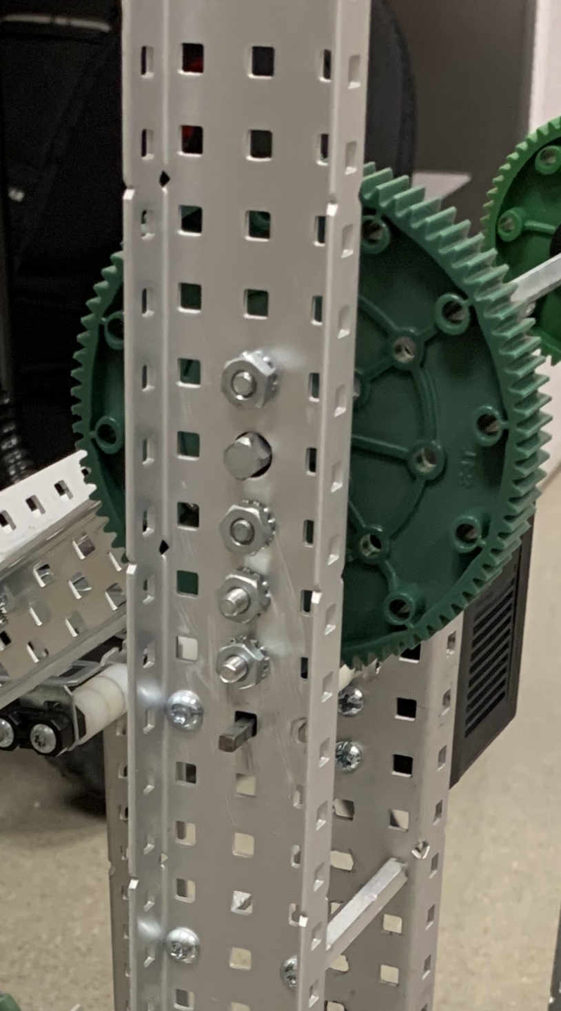

That’s some sort of a pickle… maybe cut the twisted portion on both sides and take it out so you have two straight axels to pull out.
I took off this shaft and still cannot take it off
q
We just drilled in our C-Channels and we used 5/16 and it works well…
Here is a pic

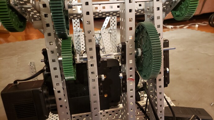

I have this and the motor won’t lift it.
Make sure the motor is a RED 100RPM Cartridge
Its 100rpm. And that would be an oof…
I just sent you a direct message

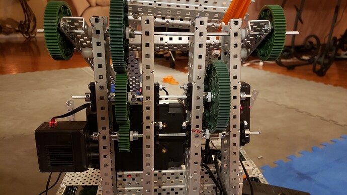

why you choose different gear ratio for left and right sides?
I didnt, it gears up.
Your left side is 36:64:84, however your right side is 12:84. The gear ratio is clearly not the same, make sure you fix this or your arm won’t lift
This would reduce torque though.
exactly, the whole gear up did not make sense and of course you twist the axis since left side fight against right side.
The gear ratio on the right is useless. as far as I can tell, it doesn’t power anything. Take that out and them make the 36T gear a 12T gear. You should have a 1:7 ratio geared for torque. Use a high strength axle going from one side of the lift to the other.
