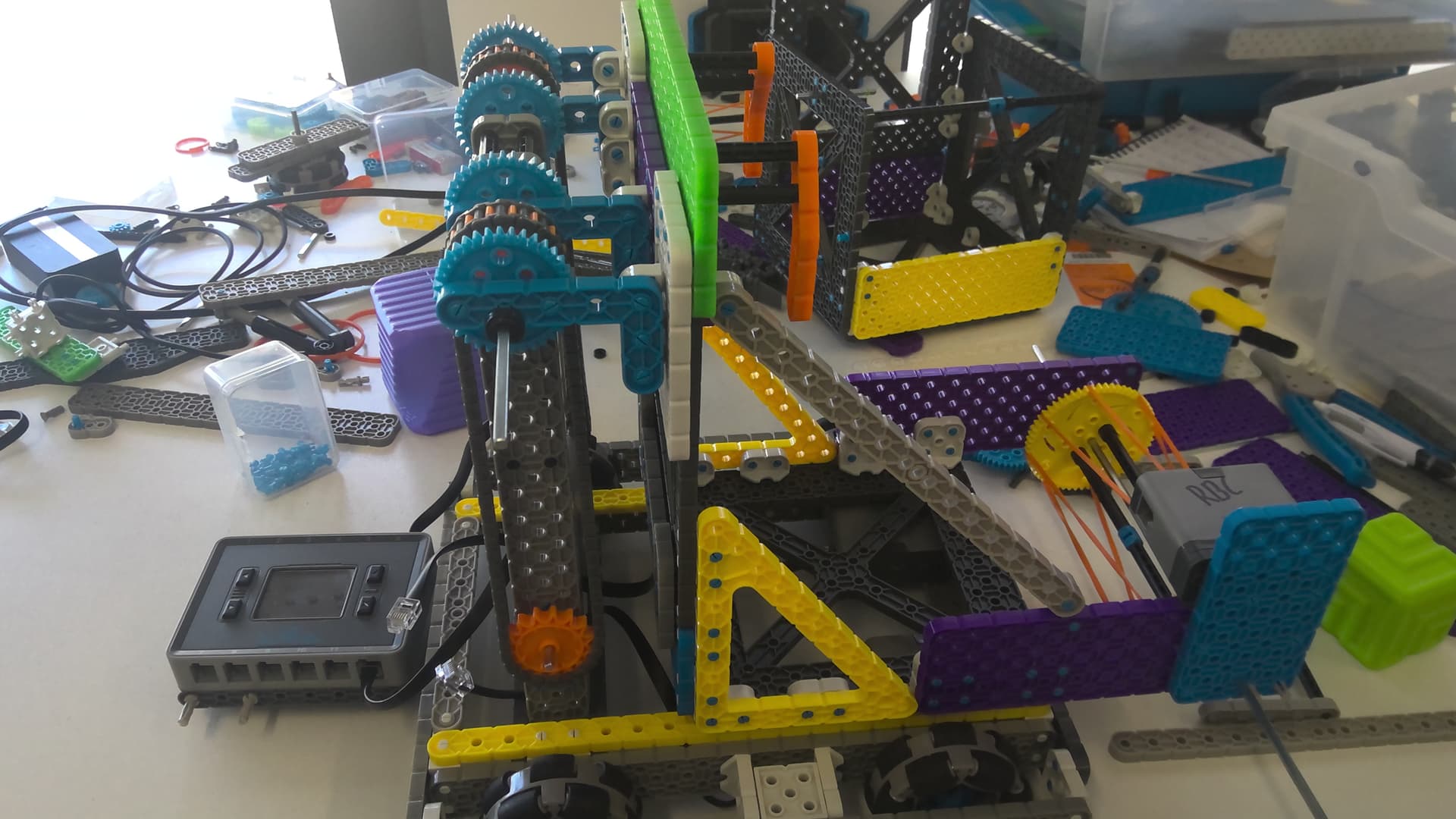

We fixed the weight problem by redesigning a new arm. Our problem now is that the chains are not moving the arm correctly, there are chains on both side and they aren’t working.
Any chance you have access to larger sprockets for the top to increase the ratio?
Looks like you have a 1:1 ratio and your motors are mounted at the bottom of riser. 1:1 will not have enough torque to bring the lifter full of blocks. A simple and quick option without redoing the entire structure is instead of attaching the motor directly to the axle powering the chain, make a gear box with a higher ratio and attach that to the axle powering the chain and attach the motor to the gear box. Take a look at this video. May help you will understanding how to use a gearbox to power a chain mechanism. Of course you will need your gears arranged in reverse order to give more power or torque.
