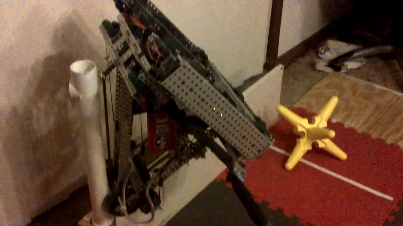

A team in hawaii made a robot that during autonomous grabbed the back stars threw it over the fence, knocked down the middle stars by doing so and launched the cube over. But after the cube was on the other side the robot would wait for another cube to come and it would throw it back. it sorta matches your situation, I personally don’t know how they programmed it but they are tied to be best in my state. When teaming with them, they told us to avoid going going anywhere near 2 square panels near them or they would try and lift us.

Here is another example from the Starstruck season. Less than a week before our States we figured out how to get our robot to high-hang. The hanging sequence turned out to be more complicated than anyone wanted or anticipated, since it needed motors to run close to their PTC limits. There was almost no way for a driver to execute the hanging without overheating PTCs. The proper way to fix it would be to rebuild the robot to be more mechanically adapted for the hanging. However, there was no time for that.
So the hanging sequence was implemented in software. To make things even more interesting / complicated there are two ways our robot could achieve the high-hanging. The first is fast, but risky (robot fell twice off the pole during the practice) and the second is safe but slow. So there is a piece of code which, at the beginning of hanging, looks at the battery level and the amount of time left in the match and decides whether to go for the safe or risky hang. I thought it is a crazy way of doing things, but kids thought it is cool, invested a lot of their time into programming it, and ended up winning Innovate Award for “thinking outside of the box.”
