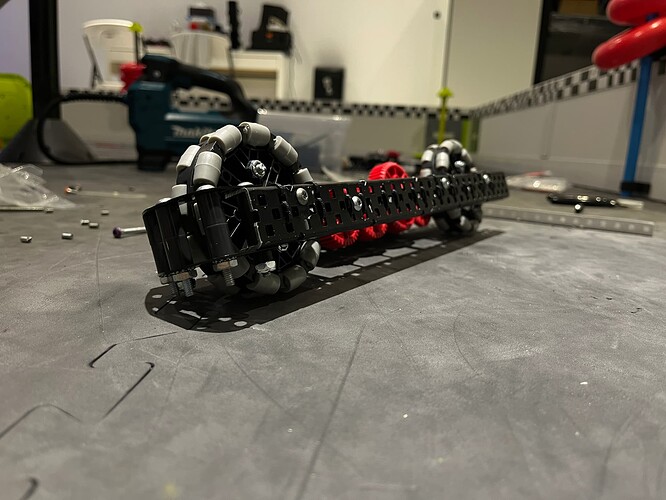

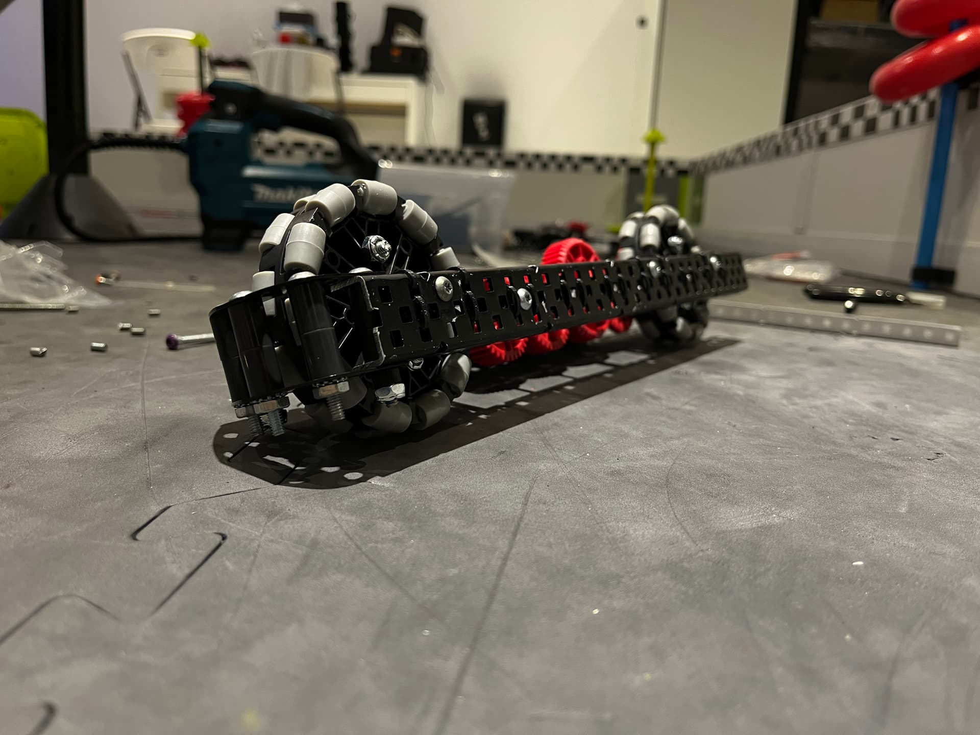

Well lets get this thread back on its tracks, we used tiptoes for our worlds bot:
sorry its a bit hard to see since we have black paint with black tiptoes but if you look closely you can see them. what you want to do is to make sure the tiptoes are vertical. this is important because it will give you a better distribution of pressure on the bearing which will make it not tilt and center better. for our nationals bot we had it horizontaly, while it worked fine, I still recommend putting it vertically like in this picutre.
NOTE:
for the bearings on the top holes you have to use 4 zipties total and 2 for each bearing holes on the sides. for the bearings in the middle of the c chan, make sure to wrap your zip tie around the bearing from the top and bottom holes of the c chan and NOT go inside the bearing holes.
PS my stupid auto correct keeps making the word zip tie into tip toes. I have no clue why, so please if you see tiptoes I tried to write zipties.
