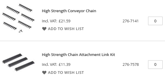

Here are the two main products designed to support bolted connections to chain systems:
The conveyor chain attaches to the side of the chain, and the normal attachment links connect in a way that lines up with your example image there.
So where the screws go through the tread, fasten a length of 1x bar on the back side , that makes a clamp. Or you can just use the metal to clamp on both sides of the chain.

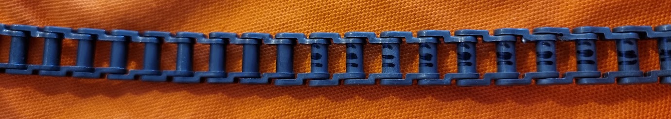

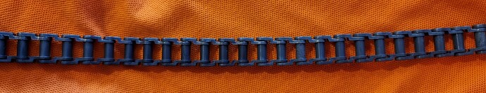

Aha, I have learned a thing, thank you, and this might help some of the old guard trust low strength chain again. So I guess it’s rebranded and replaced as 6p, and that stuff is indeed obviously different. My experience of standard strength chain is from a few years ago when it was the same shape. Here’s a photograph I’ve taken just now of a length of high strength chain connected to a length of the old discontinued low strength chain:
From Paul McKnight in July of 2021 when I raised the confusion: “For the last few years the high strength versions have been gaining dominance for use in competition robots. In truth I suspect there would be limited use for the standard chain (to the point that it has been discontinued and is only available while stocks last) but it is legal for use. You should be able to return to Rapid if you will not use it though” By that point it had been partly used up and thrown away when discovered - I marked all the remaining links with sharpie on the other side … big reveal:
If you happen to have any lying around, the discontinued impostor can find its way into competition robots and ruin your day.
This would probably be your safest bet. The High Strength Chain Attachment links have holes in them for screws, specifically designed to attach other pieces to. Ive used these before in multiple class competitions to decent success.
