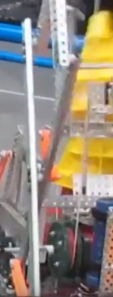

I found a picture of pretty much what I am attempting to do.
They have a custom pulley with 2 gears and rubber bands in the middle. Would spinning the gears also spin the rope that is attached?
Yes, provided it is tight enough. The rubber bands are really necessary because they add the friction that grips the rope and moves it.
@321A Thanks, that answered my question perfectly
