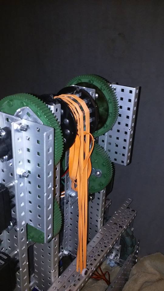

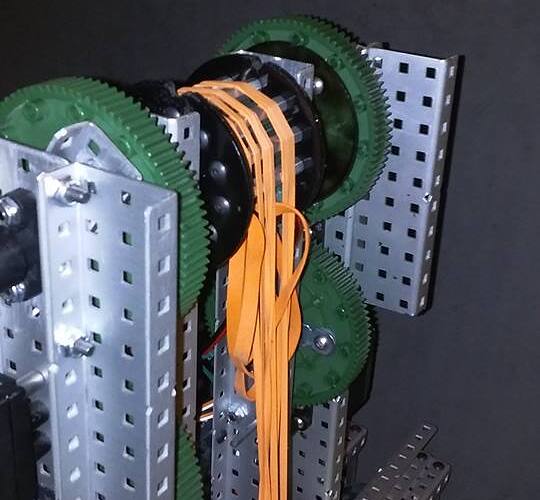

Look into using the rubber bands or black latex as a torsion spring. Use the string winch drum (see this: http://www.vexrobotics.com/vexedr/products/accessories/motion/276-1546.html ) on an axle that extends between your towers or exterior to the gearworks, at least. Anchor one end on the drum, wrap the elastic element (rubber or latex) so that it would assist the lift. Tie off the loose end.
Look at a garage door torsion spring for inspiration.
If you put the drum between the arms, you only need one. You can use things other than a winch drum, but it’s actually made for this task.
With this circular rubber band system, you get more stretch out of the rubber bands, and the stretch of the rubber bands also changes as you lift up, which is exactly what you want. The rubber bands are attached to the gear, not to the lift arm itself.
