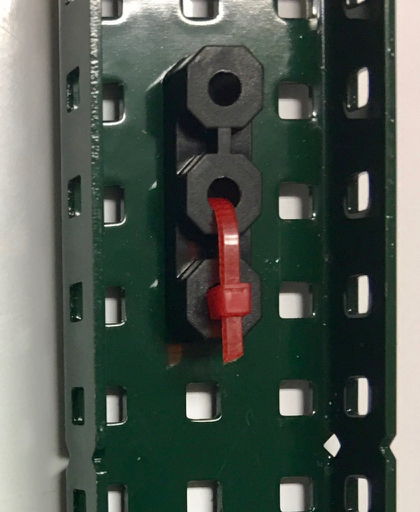

We’ve always used nuts and bolts for mounting bearing flats. For MS students with limited practice time, it’s a lot of extra nuts and bolts, often in awkward spots, to tighten. Has anyone used the attachment rivets and how did they work out?

This works much better than rivets. It’s practically as good as screws if you get the zip tie tight:
+1 we do this all the time and it works great
I’ve never seen that before. We’ll look at it. Thanks.
