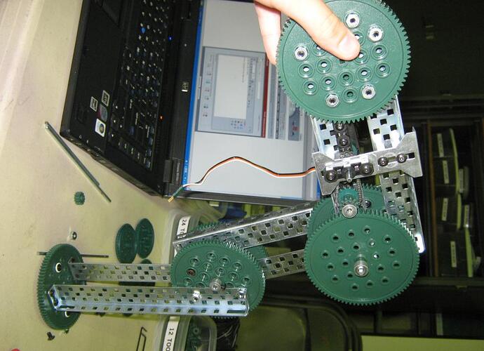

Thanks again, guys! Sorry about not being able to post pictures; I had a head-on collision with a major design flaw that I’m still working on; the gears to drive the primary hip joints aren’t wanting to get close enough to mesh properly, and there’s too much slack in a 3-stage chain drive to have that work. Redesigning…

Attached is an image of one of the legs.

If I remember correctly, unless the two 84-tooth gears on the leg joints are being used for some purpose I don’t know, you could get rid of one and mount the motor directly on the 12-tooth gear shaft - this would eliminate the chain (which felt a little flabby when I stopped by) and possibly a source of imprecision in your autonomous mode.

The main reason for the chain was because I got lazy and didn’t want to find gears that meshed at that distance. shame
