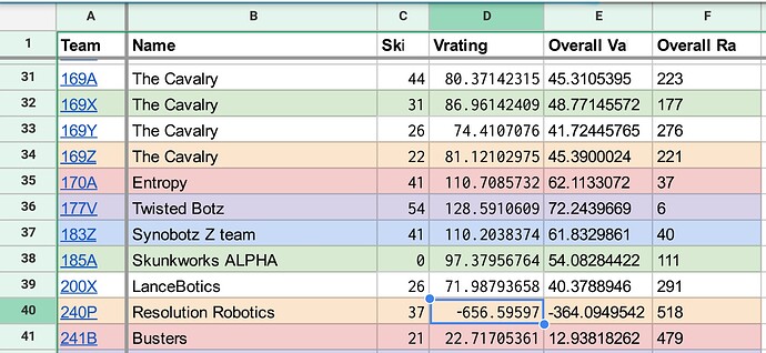

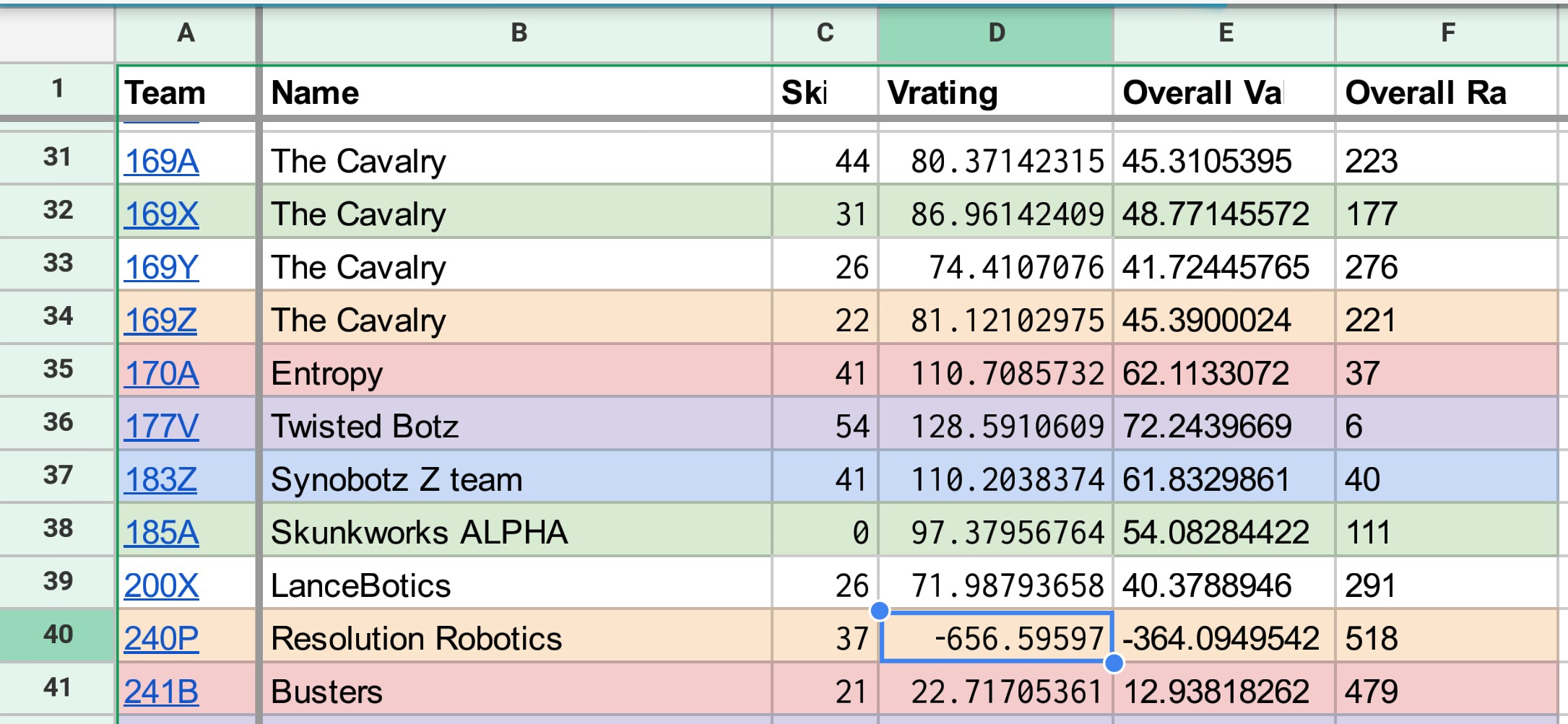

I noticed that team 240P has negative number assigned to them.
Is it because they are OP and come from down under? :wink: :wink:
_20190329_171034

It appears that all the NZ teams have that same score or withing a few points along with a few other teams. Looking through the data on vexdb it appears that no NZ teams have a vrating for turning point. I therefore have come to the conclusion that vrating probably was calculated earlier than february 22nd where our teams competed in the only uploaded comp. That would mean any teams who only competed after whenever the data was calculated will come out as a pretty low ranking. @turningPoint this is a flaw in your ranking system that you might want to figure a solution out for.
