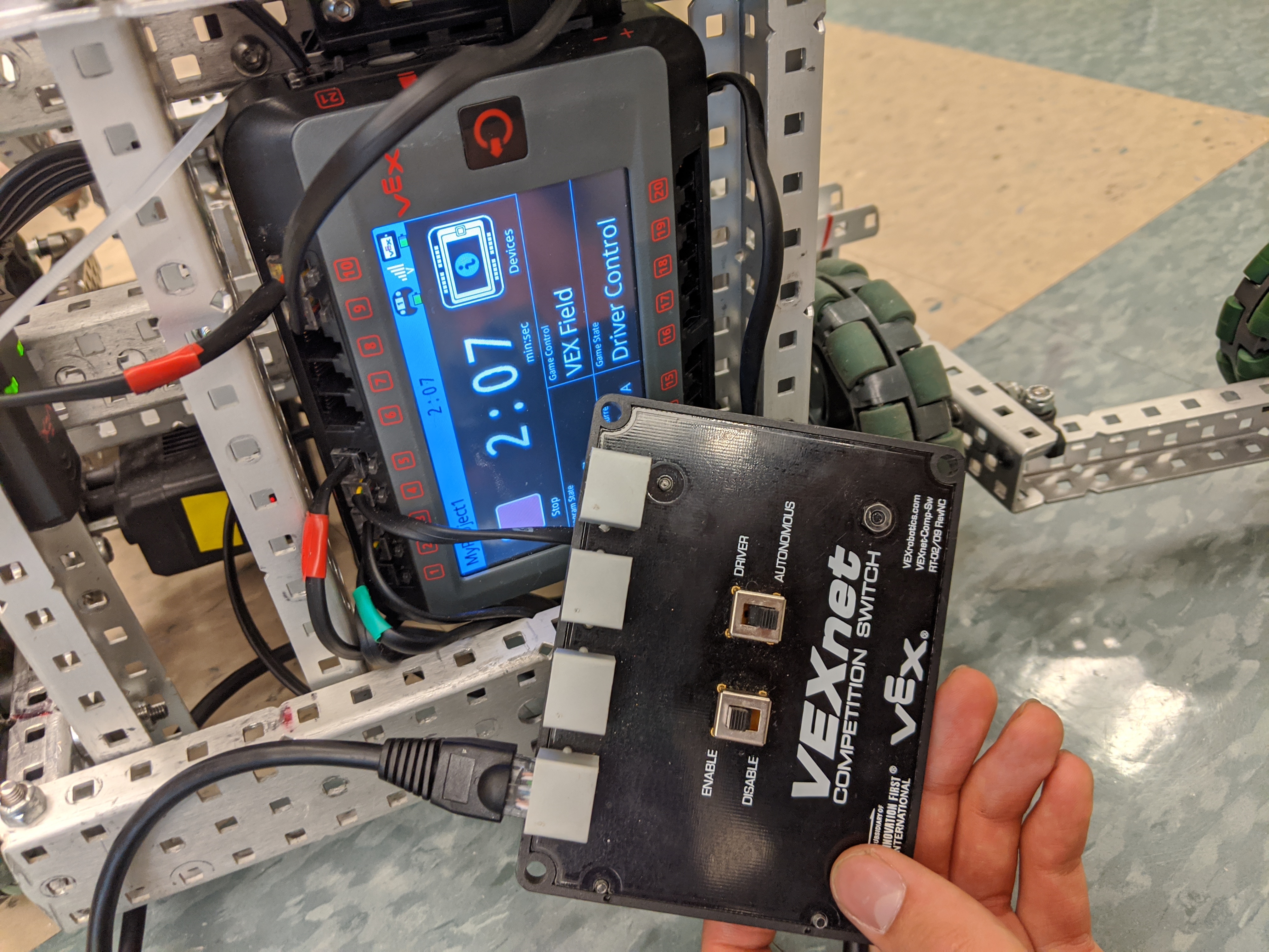

Hi, so I have an issue with running my autonomous off of the competition switch. It works fine off of my controller but does not run during a match. I have had several refs and mentors from multiple schools look at it, but still no luck.
I have run the program on a test bot and it worked perfectly. I am almost certain it is a hardware issue, not a code issue as I had the same problem in PROS earlier this year and that is the reason I switched to VEXcode. None the less I have included my code.

I feel that the issue is that you labeled the auton function differently. Rather than naming it auton…1, use different functions for different auton (im assuming the 1 signifies that you plan to have multiple) and call those in the basic autonomous function using a selector of sorts.
Have you tried opening up a new competition template and pasting your code in that. Because that might tell you if you accidentally messed up the original template. Have you tried to test other robots from the switch to test if the switch is broken. Could the problem be with the robots brain or controller?
I have tried that. I agree, I think the issue might be my controller or brain
I am a little confused about what you mean. It is only called auto1 since someone tried that to see if the issue was the function
also make sure your brain has the latest VexOS which is here:
What is the sequence of events you use when testing on a Competition switch? At what point:
  • Do you plug the controller into the switch
  • What are the switches set to when you connect the controller to the switch
  • When do you start your program.
  • What is the sequence of changes to the switches that you make
@Gdemanche, could you verify that your radio is set to VEXnet and not Bluetooth?
See step 6 here: https://help.vex.com/article/11-pairing-wireless-controller-to-the-brain
It is set to vexnet. My software is up-to-date. Is there any way to hard reset the brain so I could update it again and see if it was a transfer error during updating?
I have followed the correct steps and still no luck. I don’t think that it is a issue with the sequence
with your program running you can check competition switch status both on the controller status bar and also the brain.
test
How do I get that screen? I only get the blank screen and the status bar which says it works
run your program. press the button on the V5 brain to toggle between the user program screen and the vexos screen.
Using that screen it says driver control when I enable auto from a comp switch, what would be causing thisIMG_20191205_135248
I have now tested it using other controller and problem solved. I had a bad controller
