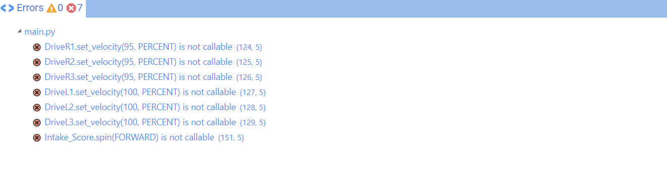

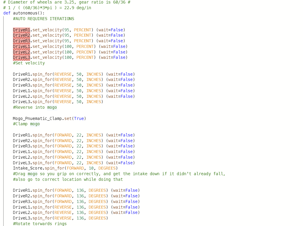

We orignally have had and still have a problem where our auto just never runs, I have tried several different ways for the auto function with no luck. Now Vexcode is giving me a weird error that even our most experienced programmer in pridetronics has no clue. We have a competition tomorrow and I am at a loss. I need both driver control and autonomous to work on 6 different programs, I have attached a small snip of our auto and the error it is (currently) giving me.

I do not know that much about python, but it looks like the (wait=False) at the end of most of your lines is causing the error. In the VEXcode python docs, for the wait parameter it says:
" Optional. Determines whether the command will block subsequent commands (wait=True ) or allow immediate execution (wait=False ). If unspecified, the default for The wait parameter is wait=True ."
This probably caused confusion, as you are not meant to write (wait=False), as the code tags are not around the parentheses; on the docs it is ( wait=False ), not (wait=False). wait is a parameter for the function and goes inside the function, e.g.: DriveR1.set_velocity(95, PERCENT, False). VEXcode thinks that DriveR1.set_velocity(95, PERCENT) evaluates to a function and you are trying to call it with a parameter of wait=False, but since DriveR1.set_velocity(95, PERCENT) doesn’t return a function to call (it returns nothing), VEXcode throws an error saying that what DriveR1.set_velocity(95, PERCENT) returns (nothing) is not callable as a function.
So essentially, remove (wait=False) and add the false statement in the code?
Yes, though make sure to note that false is not a statement but a parameter, and it goes inside the function.
