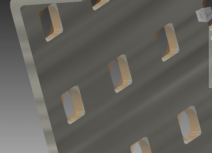

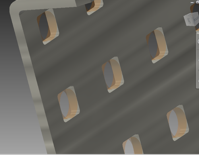

Attached are some of examples of the cylindrical features you should be selecting:
http://i.imgur.com/GCCQdoo.png http://i.imgur.com/SHwoTiK.png http://i.imgur.com/H2nzKKj.png http://i.imgur.com/eAlHVGd.png
BTW @Cyber brains , how do you put dimensional cylinders because I put circles on my C- Channels but I can’t do insert constraints or create insert i mates with them because they’re not 3d.
I don’t use the imates very often. To make the dimensional cylinders, you extrude a circle inside of the square with dimension rather than a material. 2382 I guess uses sketched circles, but I like using the extruded dimension.
