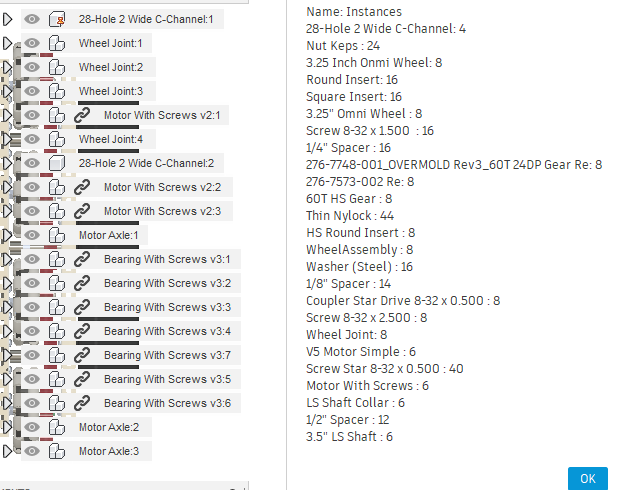

While I was cadding a base for Over Under, I thought that it might be helpful to have a way to extract a BOM from Fusion 360 and put it in the notebook. I edited a program to do that, but when I run it in Fusion, it generates parts out of nowhere and it doesn’t include some parts. Below is a photo of my chassis, the BOM fusion gives me, and the code. Could anyone help me find a way to generate a proper BOM list?

if you make a drawing of the assembly, Fusion will generate a BOM for you and you can copy that
A drawing of your assembly Could be a good thing to include in your notebook either way.
The problem with your script is that it is taking the base parts and printing them, instead of the larger subassemblies. the program is printing out a full BOM, and I definitely see a use of it, if you are trying to find, say how many of a type of bolt (or other part) are on your robot.
