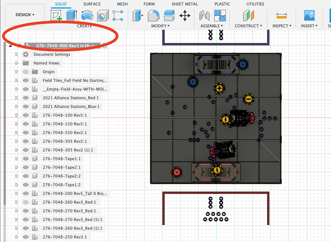

also, on the topic of fusion 360, is it normal for the browser thing not to show?
this happens occasionally, and it is extremely annoying, sometimes it won’t let me show the list of parts at all when this happens:
I’m trying to do robot renders, and since I can’t see the parts in the browser list, I can’t show the field perimeter I had hidden earlier.

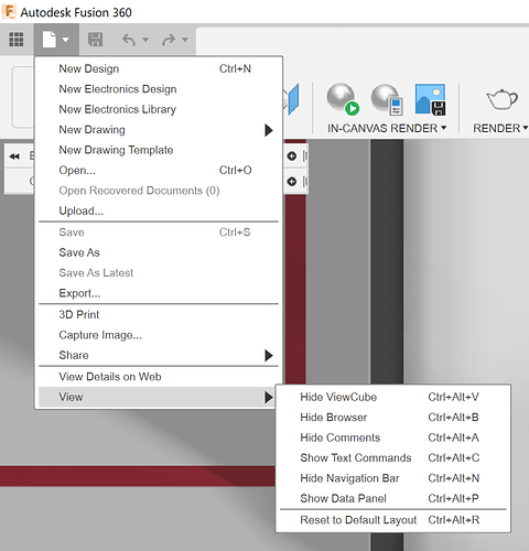

That’s happened to me once. I assumed it was just one of those overwhelmed software/environment moments so saved, closed and relaunched and it was fine. It certainly wouldn’t be intended. I’ve had the icon group at the bottom of the screen appear too low down or disappear a couple of times. Switching between open file tabs made it rethink what it was doing sufficiently for it to fix itself. That was on a galaxy book 12, which isn’t a workstation by any stretch of the imagination. Neither has happened since I moved to a more powerful machine with more RAM.
EDIT I’ve just had a look around the menus. Look for “view” in the equivalent of the file menu. Try switching whatever’s missing off and on there?
