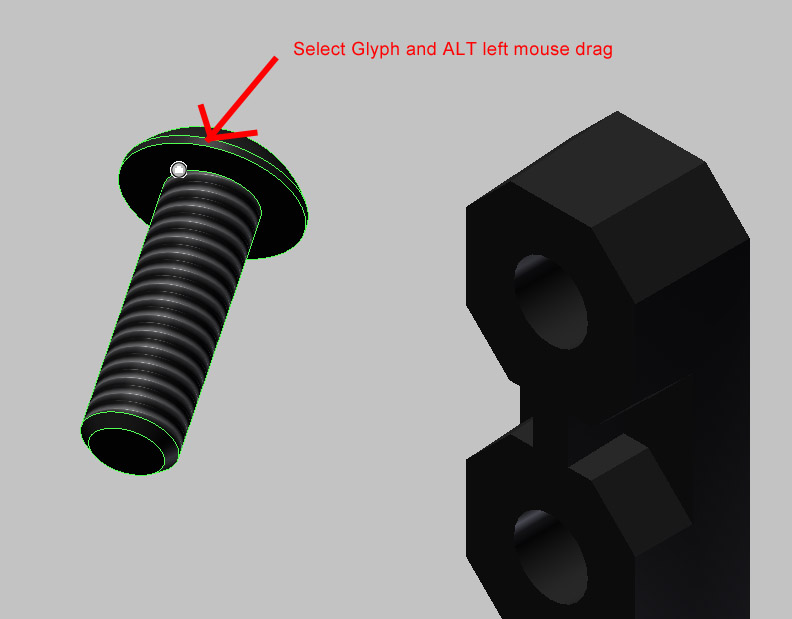

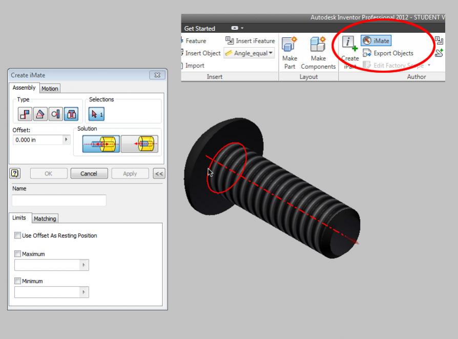

  1. Modify some parts to use iMates. These are a quicker way of adding hints about constraints to a component. For example, to constrain a screw into a hole, a normal procedure may be to open the constraints window, select insert, select the screw axis near it’s head, then select the axis of the hole into which to place it. If an iMate has been placed onto the screw then to make the constraint the iMate glyph is selected and alt dragged onto the axis of the hole, much quicker.
Here is how to add the iMate.

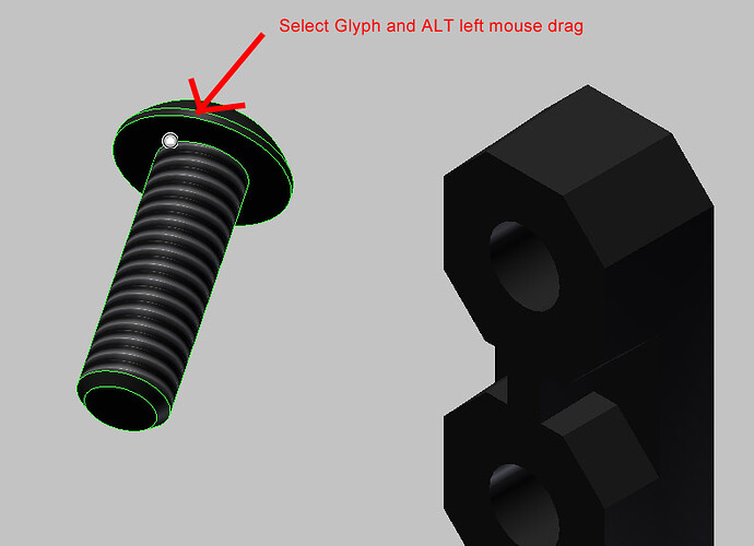

Open a part, select iMate from the manage menu on the ribbon. A dialog like the constraint dialog will be shown, in this example select insert and then the circle as shown below.
[ATTACH]6277[/ATTACH]
Save the part (or a copy)
In a new assembly place the part. When the part is selected the iMate glyphs will be shown, we only have one here, it’s the white blob.

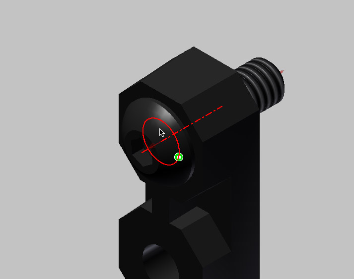

ALT click and drag the glyph and drag onto the desired hole.
[ATTACH]6280[/ATTACH]
Done.

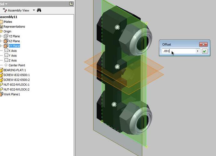

  1. Add two work axis using intersecting planes into two square holes of the structure. Offset each work axis by 0.091" to place it in the center of each square hole.

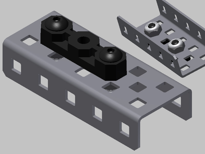

[ATTACH]6286[/ATTACH]

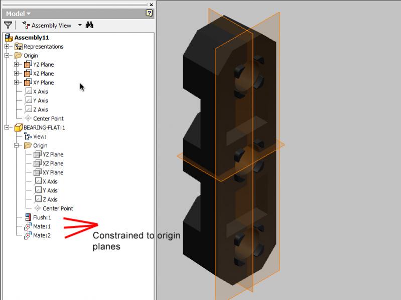

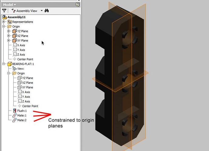

Start in the usual way by creating a “Standard.iam” assembly. Add the bearing flat as the first part. The bearing flat in my library is not located at the origin, life is easier if we move the part to the origin and constrain it to the X, Y and Z planes of our coordinate system. The reason for this will become clear at a later stage.
The part will be initially grounded as it is the first part placed, unground the part and then add three mate constraints (to the XY plane, XZ plane and XY plane) to relocate it to the origin. Finally add an angle constraint between one edge and an origin plane to stop it rotating. This is how things should look, the origin planes have been made visible for clarity.
[ATTACH]6289[/ATTACH]

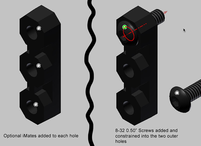

Next (and this is optional) add three iMates to the three holes, these may be useful in the future depending on how the final assembly is used.
Add two 8-32 screws 0.5" long. Constrain them using an insert constraint into the two end holes, in the image below the screws had the iMate from my last post so this could be used to make this step quicker.
[ATTACH]6292[/ATTACH]

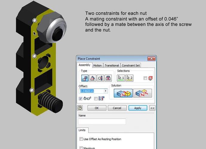

Now we need to add the two lock nuts. Each nut has two constraints added, the first is the hole in the nut to the axis of the screw. The second mates the flat surface of the nut to the underside of the bearing block, this constraint has a 0.046" offset applied which is the thickness of the steel structural parts.
[ATTACH]6295[/ATTACH]

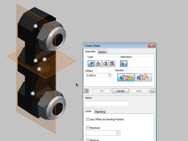

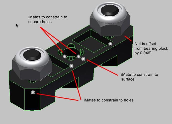

Now we need to add the iMates to be able to constrain the bearing block assembly to the square holes in the structure. The square holes are exactly 0.182" square. Unfortunately there is nothing suitable to use on the bearing flat, the small protrusions on the underside are angled and cannot be used, the sides of the bearing flat are also angled. To achieve the necessary geometry we will create two work planes, as we have already located the bearing flat at the origin this is quite easy. Offset a work plane from the XZ plane of the origin by 0.091" (half of 0.182), add a second work plane offset by 0.091" from the XY plane of the origin. With the planes visible it should look as follows.
[ATTACH]6298[/ATTACH]
continued in the next post …
continuation of the previous post…
Now we can add an iMate to each of the two work planes, the easiest way is to select the work plane in the component list on the left hand side of the work area then select the iMate option in the ribbon. The two new iMates can be seen in the following picture (as are the original three hole iMates).
One final iMate is added to the surface of the bearing flat that will mate with the structural part, this is not on this image.
In total the part has 6 iMates, three for the holes and three that will be used to constrain to a square hole.
[ATTACH]6301[/ATTACH]

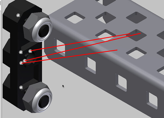

To use this new part, create a new “Standard.iam” assembly and place a structural part such as a c channel. next plane the newly created bearing flag assembly.

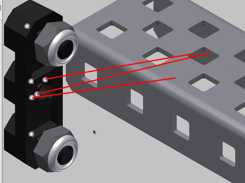

[ATTACH]6304[/ATTACH]
To constrain the part to the c-channel ALT drag each of the three iMates in turn, two will be used on two adjacent inner surfaces of a square hole, the third to the surface of the c-channel. It may take a little practice to figure out where each one goes the first time around.
After constraining it should look as follows.
[ATTACH]6307[/ATTACH]
So we have reduced the necessary steps to achieve adding a bearing flat along with screws from the placement of 5 parts and adding 9 constraints to adding one sub assembly and three quick selections and movements of the mouse.

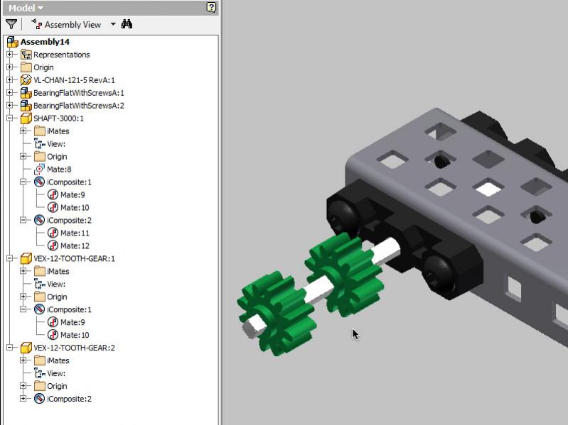

In this third and final part, I will give a small example using a composite iMate to make constraining gears (and anything else with the same size square hole) to axle shafts quick and easy. My normal way of constraining gears is to use two mate constraints on the flat inner surfaces of a gear to two adjacent faces of an axle, the gear can still slide along the axle but will rotate when the axle rotates.

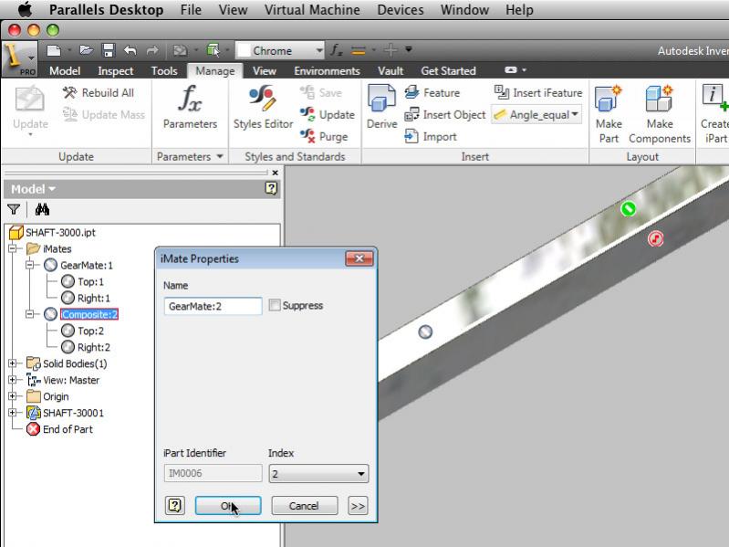

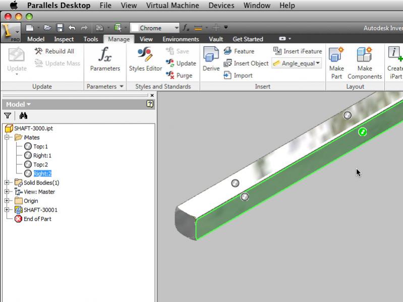

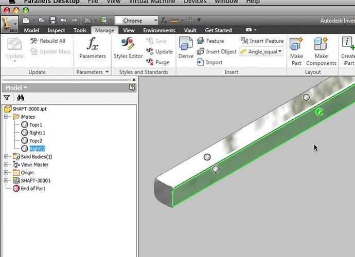

Step 1 is to add iMates to the axle, open the part SHAFT-3000.ipt and add two mating iMates to the top and right faces of the axle, rename these Top:1 and Right:1, keep the two iMates close to each other so you know they are related. Repeat this step and add two more iMates futher down the shaft and rename these Top:2 and Right:2. You should have something that now looks like this.
[ATTACH]6319[/ATTACH]

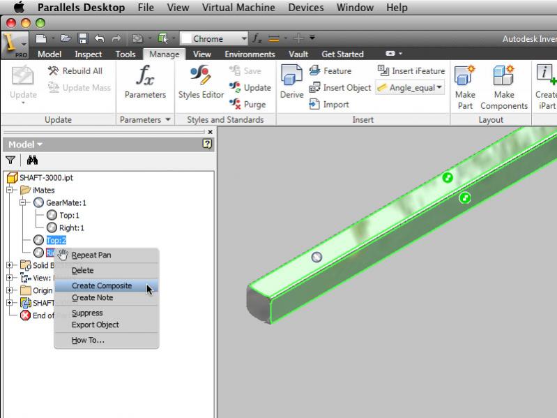

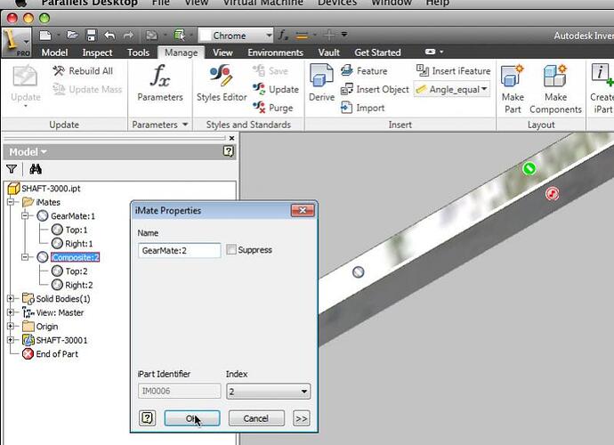

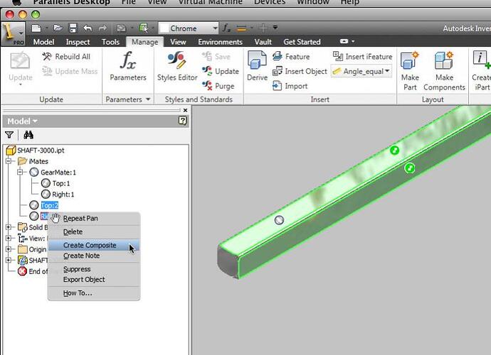

Next select Top:1 and Right:1 in the Model browser and right click, select the option to “Create Composite”, optionally rename this newly created composite. Repeat this for Top:2 and Right:2. We have created two composite iMates, this will allow two different gears to be quickly constrained to the shaft. Further composite iMates could be created if you feel that two is not enough.
[ATTACH]6322[/ATTACH]
Again, optionally rename the composite iMate by right clicking and selecting properties.
[ATTACH]6325[/ATTACH]

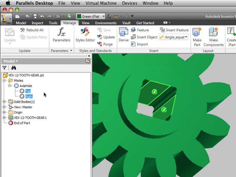

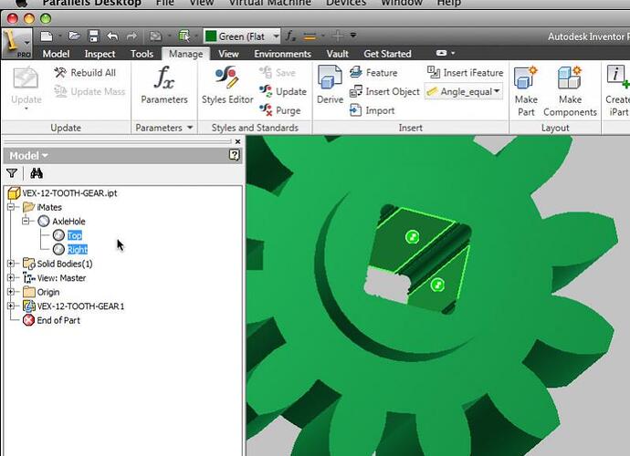

Open the part VEX-12-TOOTH-GEAR.ipt and add two iMates to the top and right hand side inner surfaces of the shaft hole, rename these Top and Right. Create a composite of these two iMates and again rename this as AxleHole.
[ATTACH]6328[/ATTACH]

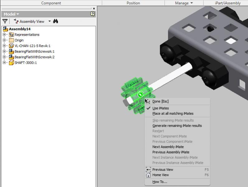

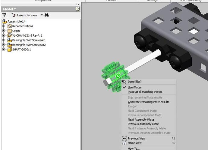

Create a new “Standard.iam” assembly, add some structure and a bearing flat or two for the shaft to rotate in. Place the SHAFT-3000 part and constrain into a bearing flat hole.
Now place the VEX-12-TOOTH-GEAR.ipt part, it will probably be automatically constrained straight away to the shaft as Inventor trys to match iMates when parts are placed by default. This behavior can be disabled by right clicking the part and un-checking “use iMates”.

A second gear can be placed, if the “use iMates” option has been un-checked the part can be ALT dragged to the matching iMate on the shaft as in the previous examples. Here is how the final assembly looks.
[ATTACH]6334[/ATTACH]
and the final project assembly.
