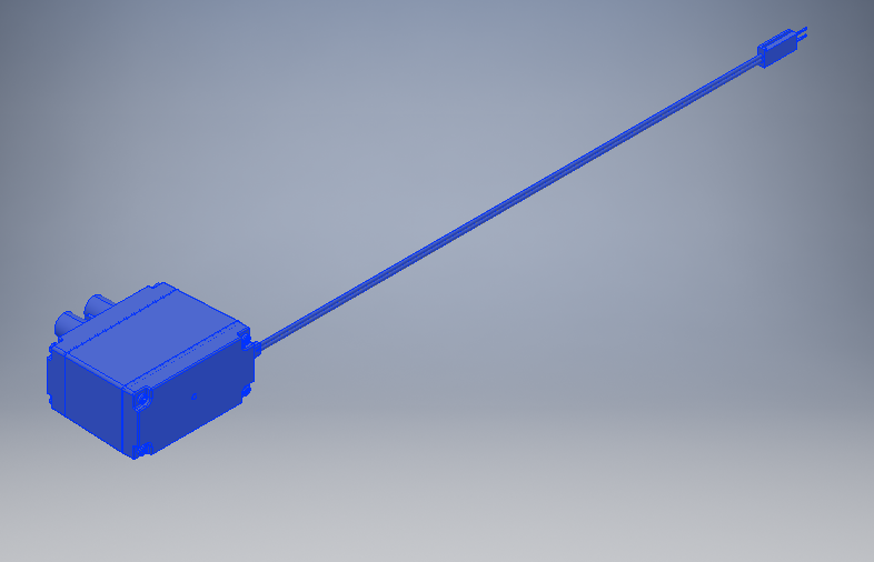

Sorry for another question. When I downloaded the parts, there was a motor. The only problem with the motor is there is a giant wire.
How can I get rid of the wire.
First, you’ve got to figure out whether the motor is modeled as a multi-body part or an assembly. I’d do it as multi body part, but my assumption is that most likely it will be an assembly. You can simply tell by looking at file extension. Part files end in .ipt and assembly files end in .iam.
If it’s an assembly file, click on the wire and see which element in the feature tree (the window with a list on the left hand side of the screen) is highlighted. That’s the wire. You can either delete it or right click on it and un-check the visibility box.
If it’s a part, then you’ll have to go in and figure out which feature is that wire, and maybe suppress it. Details are in this video starting from 2:40
A suggestion is that the more you put in an assembly, the more ram it will take up, and the slower graphic update and editing can be. A motor as an assembly has awful a lot of parts that you don’t even need in a VEX robot visualization. What I suggest doing is deleting all parts in a motor except for external casing, metal screw holes and the shaft attachment gear. Doing this makes everything faster.
I say this a lot: CAD is used to visualize before actually building, which is supposed to help you figure out whether parts might interfere, how exactly should my design come together, and if anything in general will work. Finding out something doesn’t work in CAD in most cases causes less trouble and consumes less time than actual failed build experiments, and that’s the point of modeling the robot in computer. As you get good you can also use it to do other things, such as find center of gravity if needed and doing some simple stress analysis or what not. But remember, it’s stupid and pointless to build a robot before hand, CAD it, then put a rendered picture in notebook and make the notebook somewhat nice. It kills the entire point of CAD and judges know perfectly well that students like to do this.
You could cut the wire off using the method in the video shown (just easiest method, may not be practical). By the way, no problem.

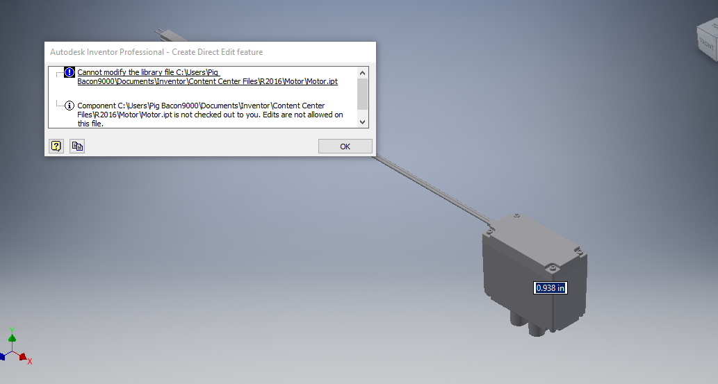

It says I cannot edit the part. How can I fix or bypass this?
Hello?
If it says you can’t edit it, it probably means the creator of this part set something up that prevents you from editing it, which I haven’t experienced before. It’s stupid. Don’t do this, people.

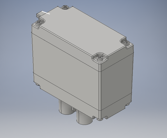

There’s probably a way to hack this. Save this part as a .STEP file, then open the .STEP file using inventor, then save it as a .ipt file again. You’ll lose access to any previous feature, the part is just a lump of geometry now, and it’s gonna lose all appearance, color, mass, material parameters. But now you can probably make a cut on it. And you can always recolor it if you want to.
